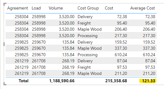

I have one table that has an agreement number and a load number, and how much was in the load.
Then I have a cost table that has the corresponding agreement number in it (what I used for the relationship) a cost group and a cost amount.
I’m trying to get the total to calculate correctly.
Screenshot 2022-02-10 182435
I tried to provide a sample isolating the processing, but I deleted some of the sample data in the process, so It may not tie back to the original sample data set.

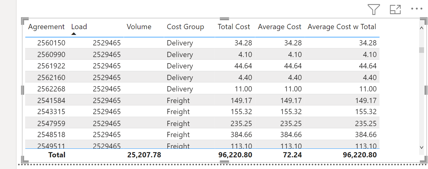

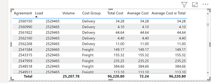

Now to get the correct total average cost:
Average Cost w Total =
VAR vTable =
SUMMARIZECOLUMNS(
    'Unique Agreements'[Agreement],
    Load[Agreement],
    Load[Volume],
    Cost[Cost Group],
    Cost[Cost],
    "@AvgCost", [Average Cost]
VAR Result =
IF(
    HASONEVALUE( 'Unique Agreements'[Agreement] ),
    [Average Cost],
    SUMX( vTable, [@AvgCost] )
RETURN Result
Note that I had to reduce the size of your dataset to check my work by exporting the CSV from the table visual to Excel (totals checked out);
I hope this is helpful. Solution file attached.

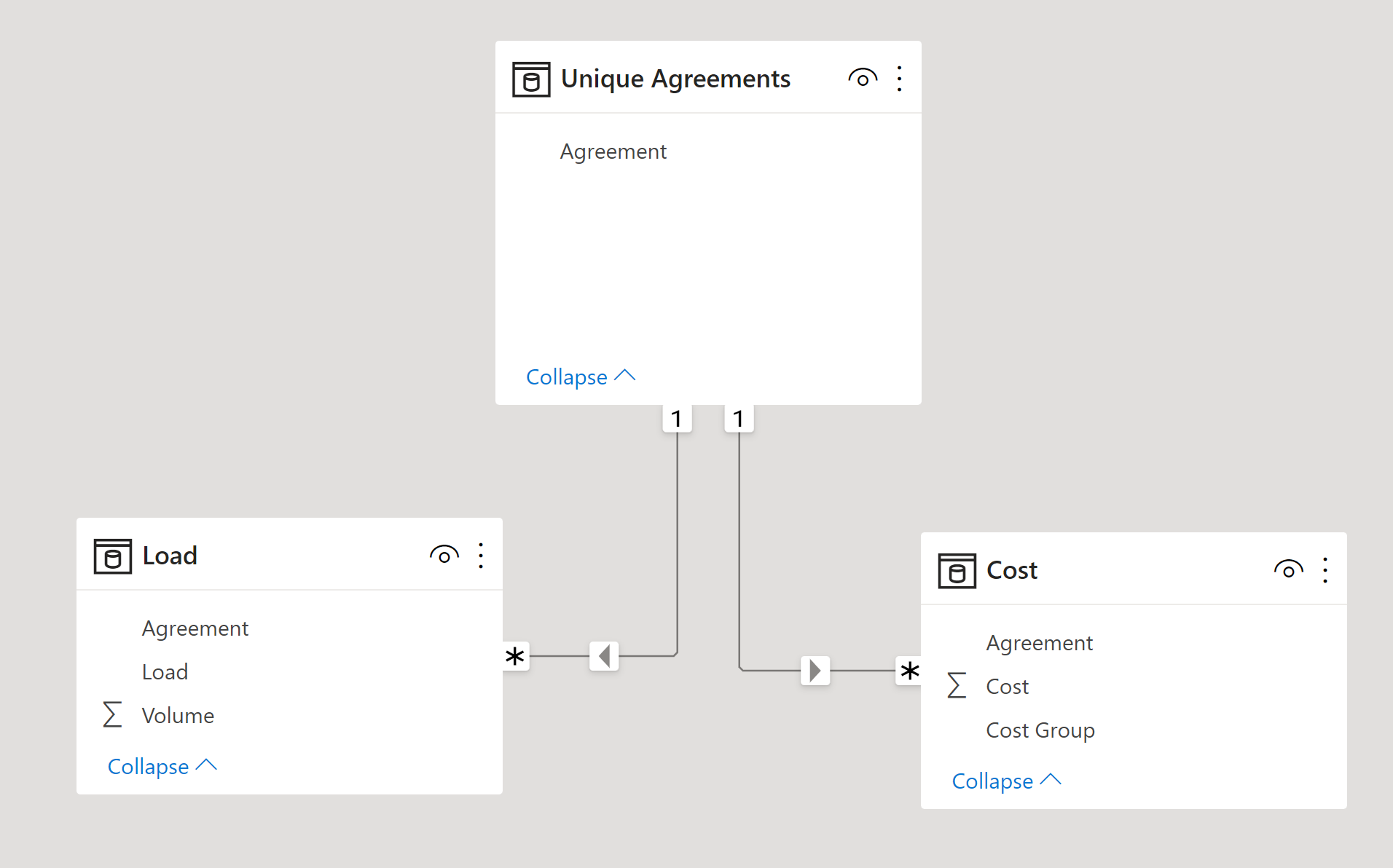

Thank you for your response @BrianJ
I realized I have an agreement table with unique agreement numbers so that solved the many-to-many relationship problem.
I have my data set up now with one-to-many relationships.

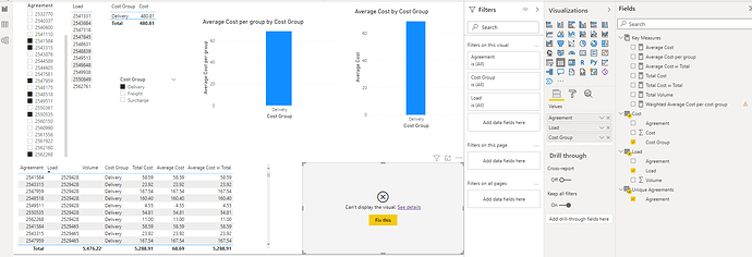

I tried a solution, but it isn’t tying out.

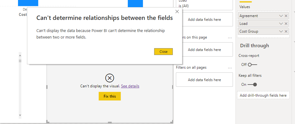

I seem to get an error when I try to bring columns from both tables now.
I brought in ‘Agreement’[Agreement], ‘Load’[Load] and ‘Load’[Volume], but when I brought in ‘Cost’[Cost Group] and/or ‘Cost’[Cost] I get the above error. I think because I don’t have the direct relationship between the two fact tables now.
eDNA Forum - Many-to-Many Sample Solution.pbix (73.2 KB)
Not sure what else I can try. Is there a way I can add columns to the ‘Load’ Table to add each Cost Group as a column? Or do a crossfilter or lookupvalue to add multiple cost groups to each contract and the cost associated with the group and contract? Thanks.

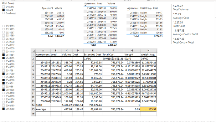

The agreements table is my lookup table, This has a relationship with the Loads table and the Cost table at the Agreement ID level. The problem is the granularity of the Load table is the Load level, and the granularity of the Cost table is the cost group, so I don’t know how to tie them.
The costs for the cost groups are the same for each agreement and load.

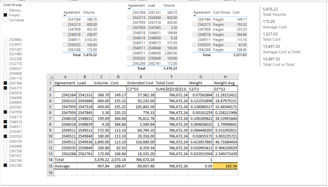

Excel Calculation.xlsx (18.4 KB)
I added an excel file to illustrate the calculation of the weighted average cost. The first problem is the table errors out in Power BI when I try to bring in the load and cost group because there is no relationship, and same with creating the calculations.
I hope this clarifies the issue. Thank you.

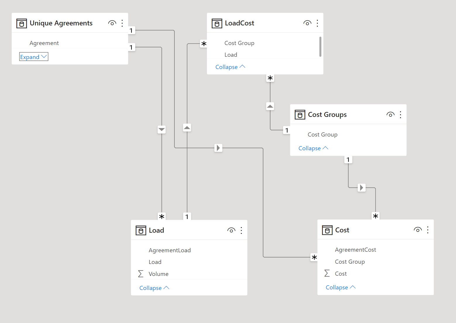

@ibesmond ,

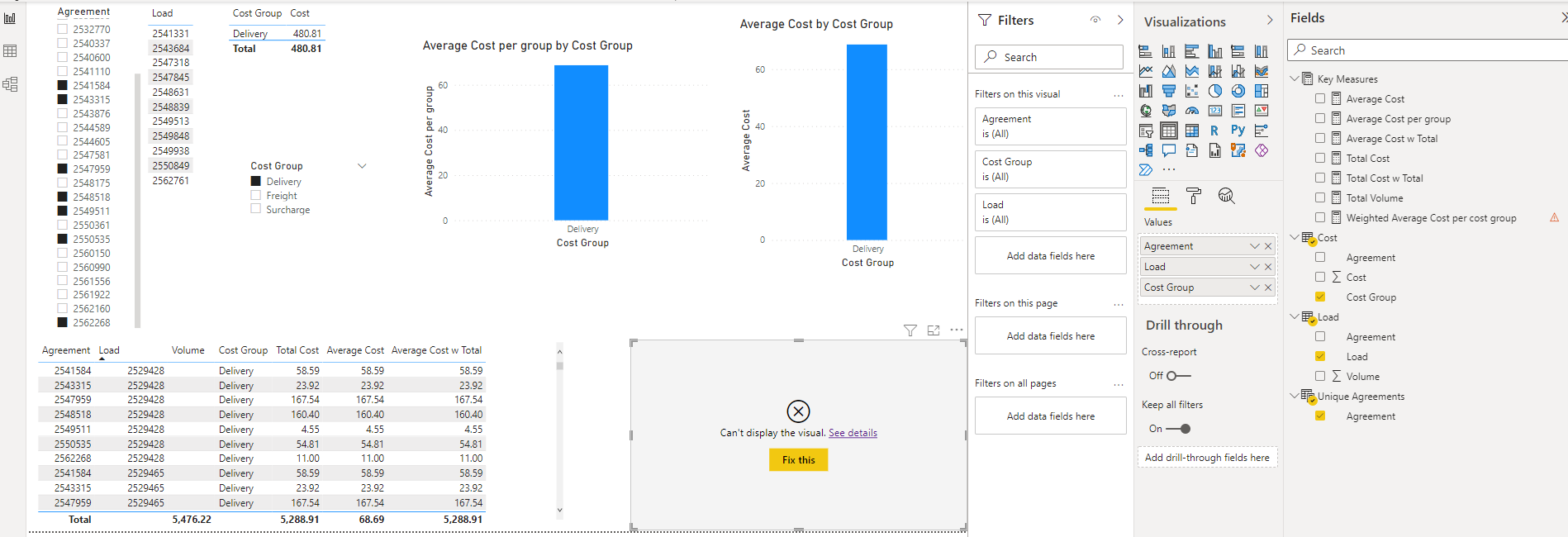

Well, good news bad news on this one. The good news is that I solved the many-to-many problem with a bridge table and a DAX CROSSFILTER function.
The bad news is that the DAX to get even a simple sum to work in the proper context is so complex as to be unworkable. Back to the drawing board – trying a different idea with a merged single fact table.
We’ll keep you posted…
  • Brian
