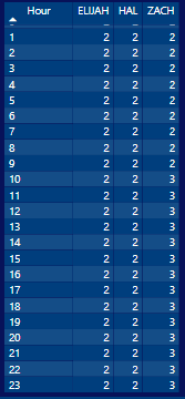

This is a Matrix with hours on the rows (0-23) and machine names on the columns, basically counting the hours the machines are busy.
What is the most interesting is that when machines are busy for longer than 24 hours, the measure populates the previous hours:
This machine starts at 8pm on the 17th and ends at 7am on the 20th, and the measure counts backwards from 8pm to 7am as you see here. Obviously this is not the intended results, but I’m much closer to solving this challenge now.
