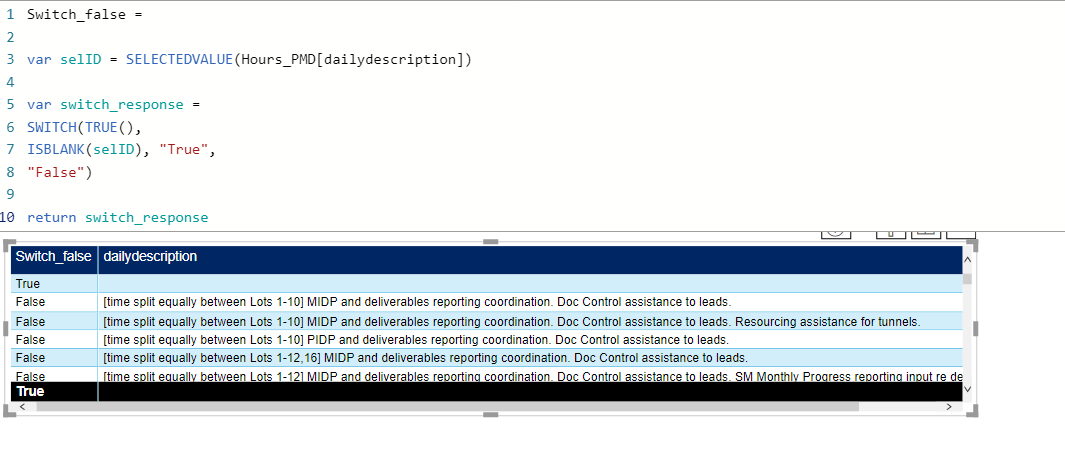

Thanks for the pickup on the switch function. I wrote this to check if both values are not blank. This looks to work for some text fields but not others. Not sure whats going on here but I agree, stay away from relying on this logic. Some other languages like Python are True if value is not None type or (Blank):
20210809_python_True
This works for some fields like description but not for id. Not sure why:
ID example below:
20210809_switch_id
For now, I’ve tidied up below and will be easier for others to read anyway.
