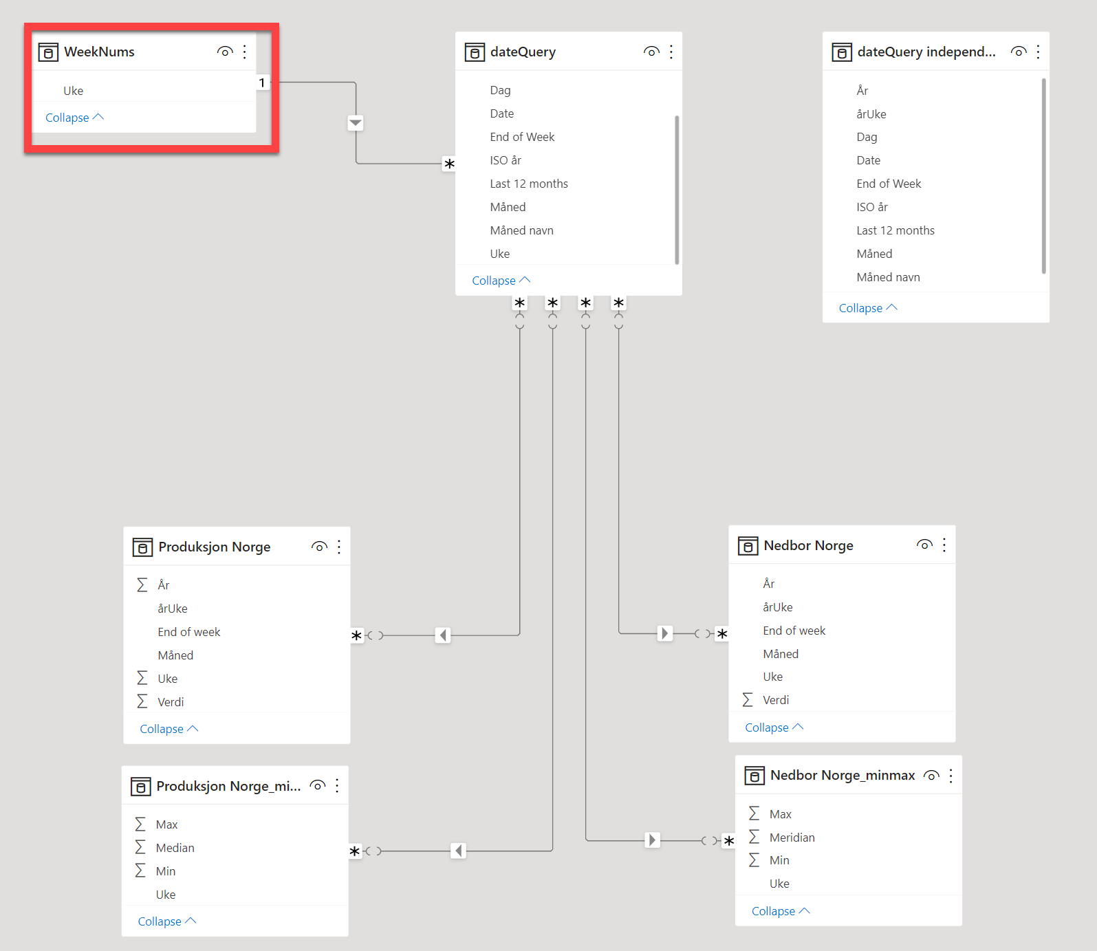

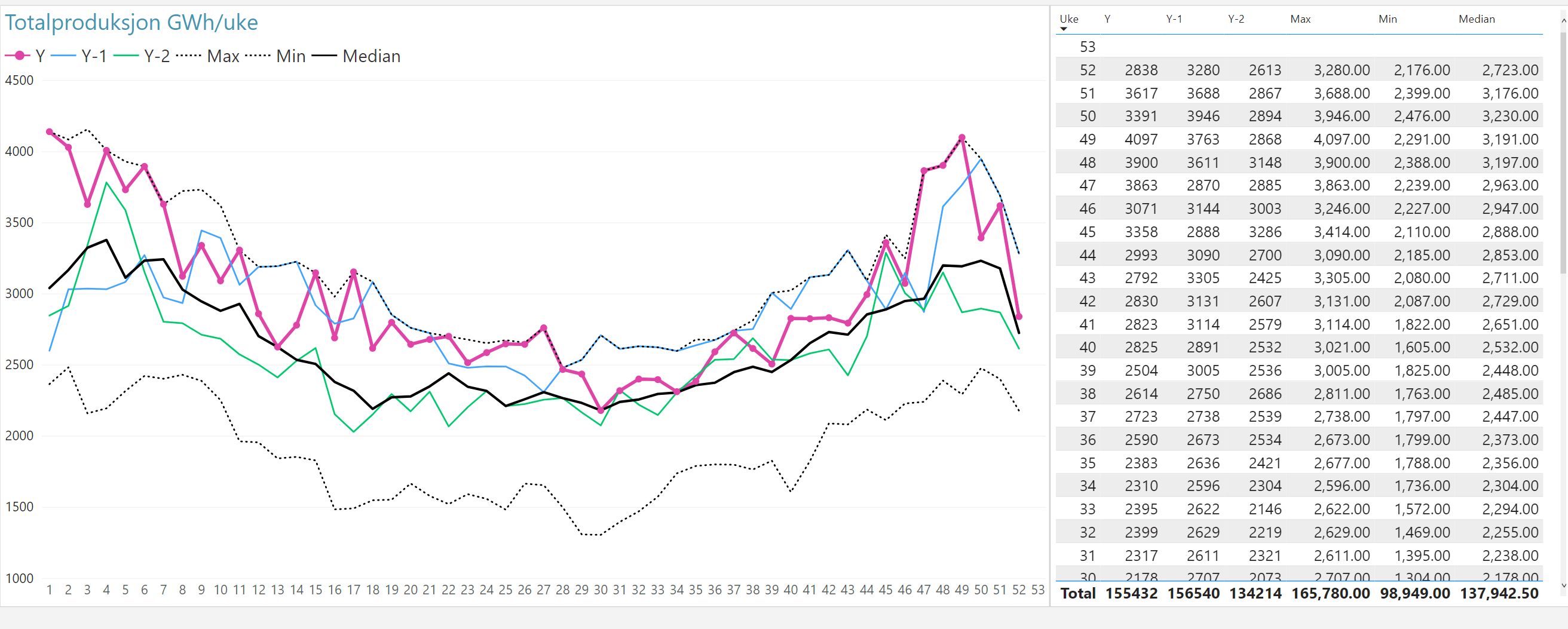

Thank you @Brian I tried the solutions you advised and
1.Adding a Disconnected table, makes week 53 show for those years with 53 weeks but it does not show for Min, Max, Average - and it should regardless of the year selected.
2. Within range filter. Starting with week 40 solutions does work as long as there is one year in the visual. But it does not work if we compare current year with previous years in the same chart.
I guess my biggest struggle right now is the relationship between fact and dimension table when I don’t have daily date. I have a column for Year, Week and i added WeekEnding date (20/02/2022) or YearMonth (202207). But it does not work.
I used Group by as you suggested. and determined the relationships, added DAX measures, but since the relationship between fact and dimension table is wrong, nothing works.
Hope that when i get the right relationship, i will understand better solution you propose :confused:

Hi @Irina - Yes for Week over Week analysis or Prior Year analysis, daily data is necessary in Fact table. Is it not possible to add dates in the Fact table.
Ankit J
