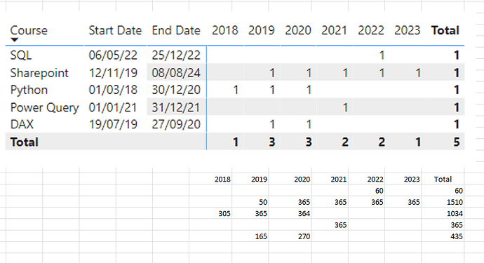

I’ve got a bit of a diagram of what I need. I can get the top part ok. But am looking for the no of days in the year or month, like the bottom part I have done in excel (just plugged some numbers in).

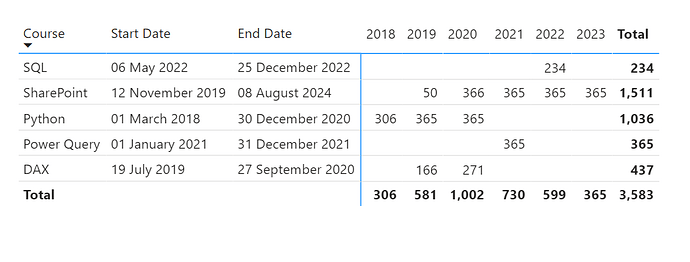

Hello @meldon,

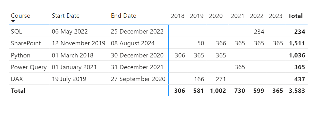

In order to achieve the results based on the scenario that you’ve mentioned. Below is the DAX measure alongwith the screenshot of the final results provided -
Distribution Of Days =
VAR _vTable =
SUMMARIZE(
    Data ,
    Data[Course] ,
    Data[Start Date] ,
    Data[End Date] )
VAR _No_Of_Days =
COUNTROWS(
    FILTER(
        CROSSJOIN(
            CALCULATETABLE(
                VALUES( Dates[Date] ) ,
                Dates[YearOffset] <= 0 ) ,
            _vTable ) ,
        Dates[Date] >= Data[Start Date] &&
        Dates[Date] <= Data[End Date] ) )
RETURN
_No_Of_Days

Distribution of Days - Harsh.pbix (125.7 KB)
Thankyou that’s brilliant! I knew I had to create to create a virtual table of dates but couldn’t work out how.
