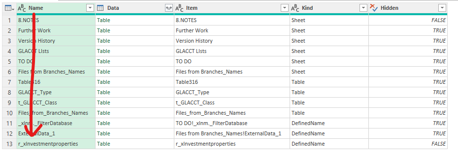

Hi @AllisterB,
Key match lookup is applied to the table depicted below, therefore Kind= “r_xInvestmentproperties” can only return null after which a conditional branch should start else subsequent steps will return an error please refer to the LinkedIn post for available options
Kind= “r_xInvestmentproperties” can be replaced by Name= “r_xInvestmentproperties” if that DefinedName is present in all files.

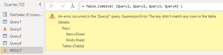

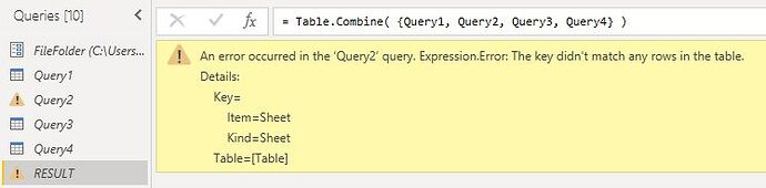

Hi Melissa
Thank you for a very helpful explanation about the working of Kind on the Table.
I have read the Linkedin post and have tried to use Method 3. My problem is that I am unsure of what, in my case, would replace the Query1 Query2 etc.
My best attempt is below - it results in a 1 row , 1 column table with the feild Custom and no contents.
Could you provide the code i need.
Also do you have a link to a tutorial that might help me understand how to use code such as that in your linkedin post and adapt it for one’s own use.
Thank you
Allister

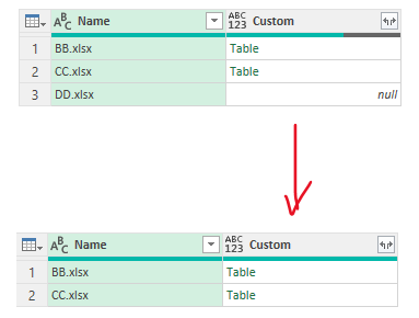

What I’ve done is the following: Placed your 2 sample data files in a folder and added an empty file called DD.xlsx (so this does not include your NamedRange).
let
  Source = Folder.Files(FolderLocation),
  // this adds a column with the NamedRange table and returns null if not found
  AddCustom = Table.AddColumn( Source, "Custom", each
    Excel.Workbook( [Content] ){ [Name = "r_xInvestmentproperties", Hidden = false] }? [Data]?
  // clean up other columns (can be replaced with Projection)
  RemoveOthers = Table.SelectColumns(AddCustom, {"Name", "Custom"}),
  // the first filter argument filters out the nulls (when the NamedRange isn't found), the second filter argument was already present in your file.
  FilterRows = Table.SelectRows(RemoveOthers, each (
    [Custom] <> null) and (not Text.Contains([Name], "$"))
in
  FilterRows
With this result, after which you can expand the Custom column.
