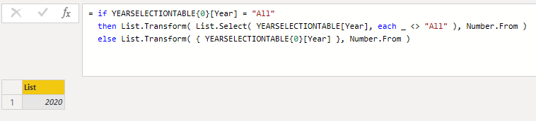

Add an 'All" option to the YEARSELECTION table and turn the column type to text. Update the YearVariable as depicted below:

Hi Melissa, thanks so much for your help. It worked almost perfectly. I amended the YearVariable as you showed it, like this
= if YEARSELECTIONTABLE{0}[Year]=“All”
then List.Transform( List.Select( YEARSELECTIONTABLE[Year], each _ <> “All”), Number.From )
else List.Transform({YEARSELECTIONTABLE{0}[Year]},Number.From)
and I updated the filter like this
= Table.SelectRows(#“Renamed Year”, each List.Contains( YearVariable, [OrderDate.Year] ))
and it worked great as long as my YEARSELECTIONTABLE contains an actual year.
When YEARSELECTIONTABLE contains “All” however, I got an error message to say "DataFormatError, We could not convert to a number. Details: “All”
