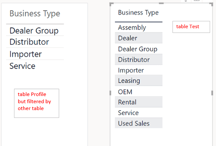

I have a list in my visual that already filtered by other table, so the filtered is this one →
But when I test the result by creating a table with DAX :
test = ALLSELECTED(Profile[Type])
Then when I show another visual just to show the table test, it is listed me the whole rows of origin table (table Profile). This is also happened if I’m using VALUES(Profile[Type])
Something like this on my page now :
How to get the same list ?

Hi ,
The profile has active filter as you mention in your description but when you create the above test table where are you viewing it?
I am assuming you are viewing it on table view so in their is no active filter you have to mimic filter by yourself and you will same result.
Let me know if this solve your issue if not then can you be more descriptive about your query and if able to provide a pbix that it will be grt also.
Hi Anurag,
The table test is created with that DAX command → ALLSELECTED, so I’m quite confuse how to answer where I’m viewing in that picture. If it is in table view, yes, it is showing all rows as well, and I though the same as you’re mentioned whereby there is no filter in table view. But in that picture is displayed in report view.
When I double check again, in report view, there is no filter on both. The two table visual are with the same filter like this :
But as mentioned, the 1st one, is filtered by its relationship to other table. And the test table is for me to check only → test = ALLSELECTED(‘Business Profiles’[Business Type]), from what I think is I would have the same list.
