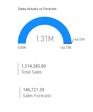

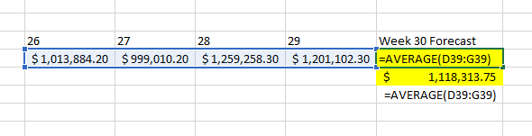

I’m trying to create my forecast by looking averaging the last four weeks sales.
I had download the DATEADD function tutorial to try and work out the logic I required.
DAX formula that I have written is:
Sales Forecast - average of last four weeks =
CALCULATE (
    AVERAGEX ( VALUES ( Dates[Date] ), [Total Sales] ),
    DATEADD ( Dates[Date], -1, MONTH )
However the result is not returning the correct figure when I slice the data by week, Is the above formula correct?
I would ideally like to create my forecast and then compare actuals to forecast each week, but my figures are not summing correctly
