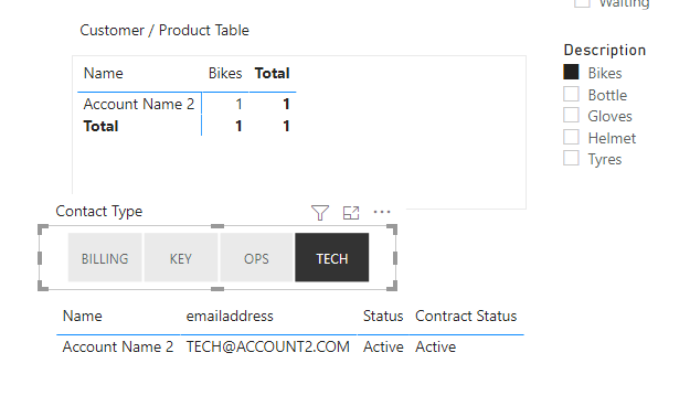

Filter table based on a filtered table
I have a product/customer matrix that shows what products a customer has - I can filter that by product to give me a list of customers.
I have a table of contacts that I want to filter based on the customers that appear in the table above and the contact type filter
At the moment both tables filter but not unless I select a customer in the product/customer table. I want the contact table to filter based on the filters that have been applied to the customer / product table.
How can I do this please

Thanks Heather. I’m not sure what that is doing / how it suppose to work
I’ve added that to the visual but when I change the contact type it doesn’t filter the contact table correctly
it returns all the contacts for the given type rather than just for the account in the customer/product table.?
It worked for the billing contact type but not the others

Hi Heather
It is that table that I want to filter but it isn’t filtering by adding that measure
This is the result I’m getting
This is what I would like: ie the Active Key contacts for Account Name 1 (as filtered in the customer/product table
If I change the Contact Type slicer the Contact table would update with OPS Contacts for Account Name 1 etc
I’ve tried changing the relationship to the Quote but that doesn’t work either :slightly_frowning_face:
Is what I’m trying to do possible?

Thanks Kumail much appreciated.
It’s not quite working on the Contact Type filter how I would expect.
If I leave the filter off contact type and just filter on the Product - both tables show the correct detail. ie all contacts for the customers in the Customer /Product Table
However, if I then set a filter on the contact type it also changes the customers that appear in the product/customer table
I would expect to see the following in the customer / product table regardless of the filter applied to contact type.
Is that possible?

Hi Kumail
Thanks for all your help so far … contacts is now working (great) but that has made the product filter / contract status filter not work anymore.
It is returning customers that do not have an Active contract for a given product
PB Test Model -update.pbix (234.0 KB)
When in fact Account 1 only has 1 Active contract for 1 product
How can I get that back working?

Hi Kumail
I can create another ticket but I think its related to the relationships we now have. Originally the customer/product table was filtering correctly. Now we have made the changes it isn’t ?
Hello @AliB
Can you refer to the source table that “When in fact Account 1 only has 1 Active contract for 1 product”
Currently it shows Account 1 has 2 active contracts.
This is what is reflected in the visuals.
Regards
Kumail Raza
