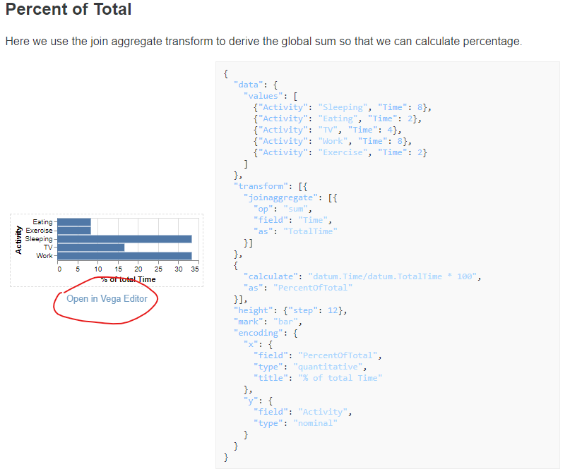

If you like to control your own dosage, I recommend carefully studying the Vega-Lite Documentation and working through the examples peppered through the docs. Every time you see a “Open in Vega Editor” caption, click that link and play around with the example:

Thanks for the kind words @HufferD. Totally agree on the use of the “Open in Vega Editor” option on the Vega-Lite website … that’s how I’ve learned pretty-much everything about using Vega-Lite. As for datasets and Visual Studio Code, yes, I use that frequently if I can mock-up a representative dataset, do the dev work in VSC, then copy-and-paste back into Deneb and reset the dataset. Unfortunately easy mock-up data creation is few-and-far between, so I actually end
-up not using VSC much.
