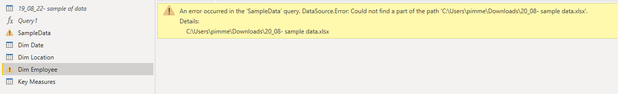

@Iwona
Replace the C\ untill the last \ with your file path and it will work.
It’s just the path of where i saved the 20-08 sample data file you provided in the original post.
