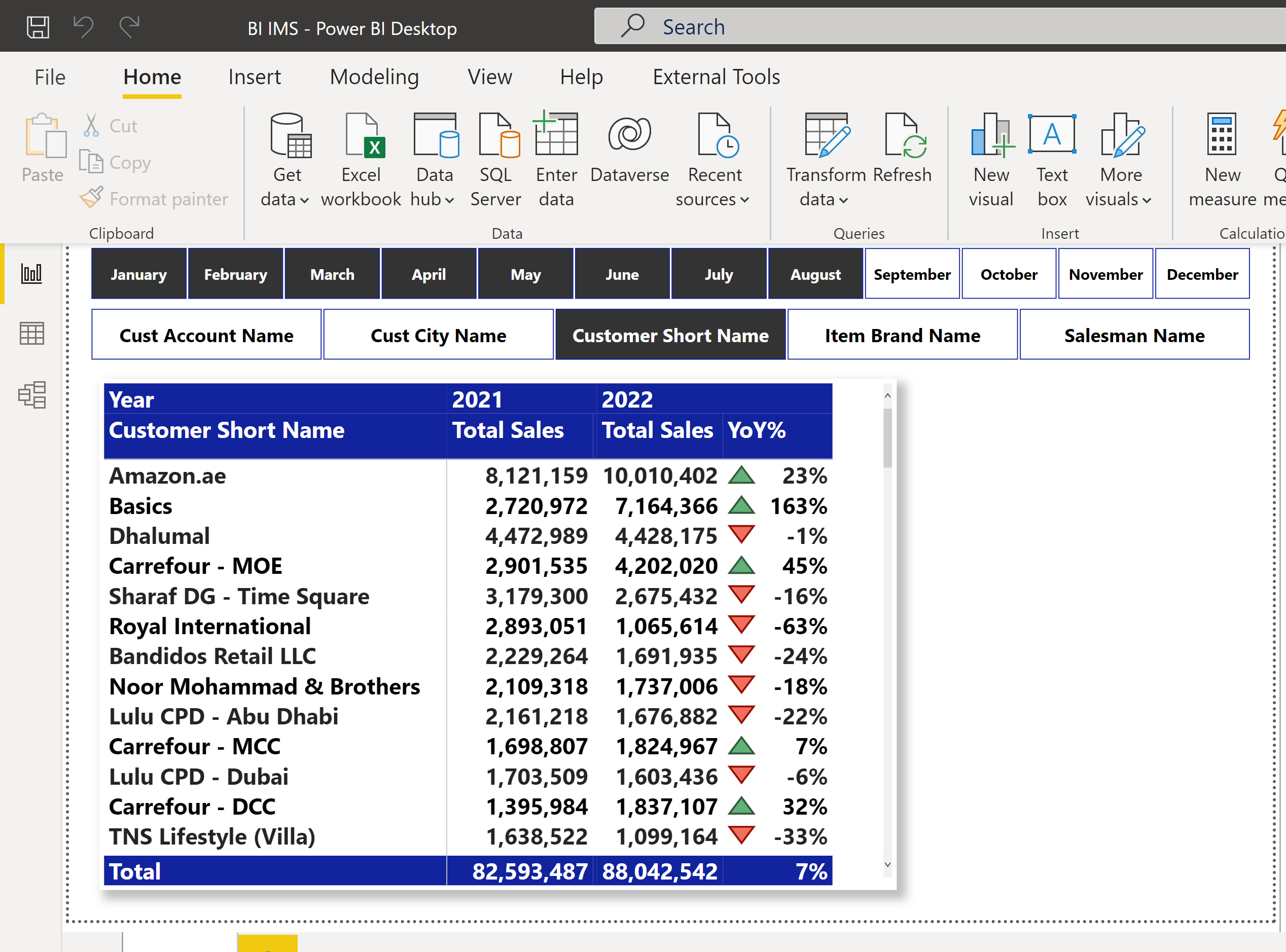

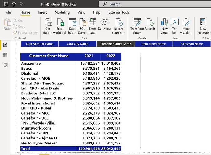

I have a matrix where one of the fields is a Year column, so I have Year 2021 and Year 2022.
As a filter I am using the new Fields Parameter. How can I calculate the Year over Year percentage so that the Year over Year calculation updates automatically.

The problem is that Year is a field in the master data, so in the matrix Year is put on columns, so if I use the divide function it dosen’t work. Also, in my formula, I would like a dynamic calculation instead of hardcoding the Year numbers.

@chris786 , so basically you just wanted to have a current year comparing to prior year? First, you need to create a date table and have the relationship with your master data. Then create the prior year calculation using SAMEPERIODLASTYEAR function. Lastly, create the measure that you have on YoY% if that makes sense?
Sales Prior Year = CALCULATE([Total Sales], SAMEPERIODLASTYEAR(Dates[Date]))
YoY% = DIVIDE([Total Sales], [Sales Prior Year],0)
Yes, I forgot to create the relationship with the Date table and Fact table. Have done it now and it works.
