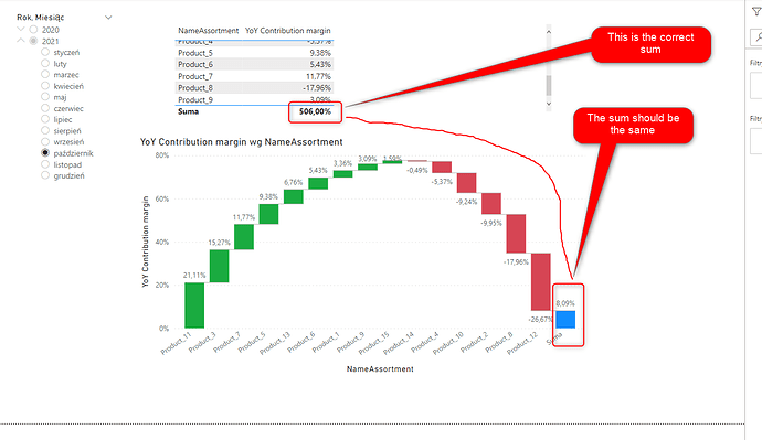

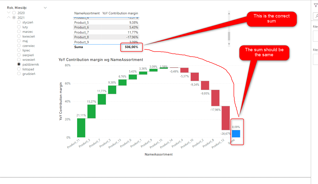

Wrong sum on waterfall visualization
Please help with a simple metric. In the table, the sum of the metrics shows correctly. On the Waterfall and similar charts, the sum is completely different and it is the same metric.

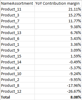

If we load the data into Excel, we can see that the Total row in the table should be returning 8.08%

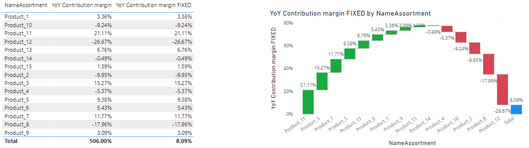

Now we can see that the Total in the Waterfall Chart is correct, but the Total in the Table is wrong.
To fix it, we simply need to force the row-by-row calculation using SUMX()
Fixed
Now we get the same grand total as we see in the Waterfall chart
