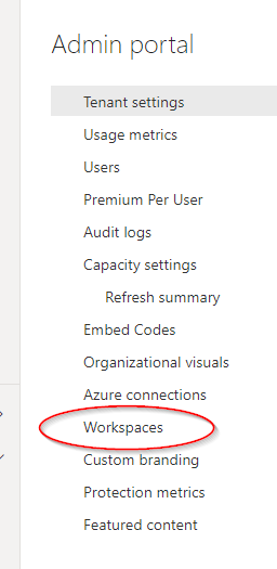

you will need to go into the Admin portal to find additional workspaces (click the gear icon in upper right, then Admin Portal)
Once there, you will need to locate the “Workspaces” menu in the left hand side:
You will see all active and deleted workspaces listed - including those you don’t have access to
You can Export, see Details (number and name of reports), Edit (the description of the workspace), see what Capacity it’s in (is this a Premium workspace), and update the access for each workspace. I don’t know of a way to bulk update all workspaces.

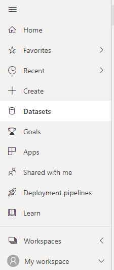

I wanted be able to access them via the Side Menu
I think the only way I can do that is add myself as Admin to each Workspace which would be ok if there only a handful but there are hundreds. :slight_smile:
