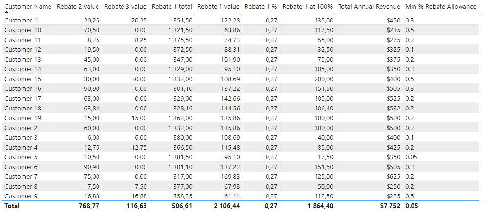

So I was able to identify what is not working but I am not sure why.
My model has an additional layer which I have added to the example file.
I have added a new measure “Rebate 1 at 100%”. This represents how much rebate would represent if this was paid at 100%.
To define “Rebate 1 %”, I divide the current rebate 1 Total by “Rebate 1 at 100%” . Based on the printscreen below the result is 27%
However, this is not the what I get in the table, the column shows weird results.
Interestingly enough, if I remove the “allowance” row, then the % is correct, but the “rebate 1 value” is not the expected value.
Any toughts?
Best regards
Rebate example.pbix (38.5 KB)
Hi @JayLocher,
I managed to understand why there is a problem.
You need to change the Rebate 1% like that :
I’ve changed the ALL( Data[ Customer Name] ) with ALL( Data ).
In that way, you can add on your table all the Data columns you want and the result will not change.
Nonetheless, the best practice is to always create measures to show data numbers on tables and not use the data directly.
So I’ve created a Total Annual Revenue measure
And another one about allowance
Then I’ve changed the measure Rebate 1 value just to use the Total Annual Revenue I’ve created
With all the changes have made, the formulas seem to work.
Here is the result :
I hope this time it will answer to your problem.
Rebate example (1).pbix (39.4 KB)
Best regards,
Joaly
