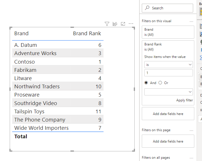

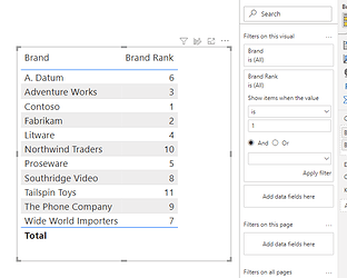

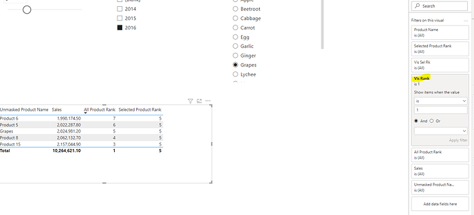

The issue i’m now facing is when implementing this logic into my Main model, i’m finding the visual takes a while to load.
The culprit measure is the filter measure at the visual level:
Vis Rank = VAR Result =
    IF(
         [All Product Rank]>=[Selected Product Rank] - [Parameter Value]
            && [All Product Rank]<=[Selected Product Rank] + [Parameter Value],
        1,
        0
RETURN
    Result
Is there a better way to handle this so the visual loads faster?

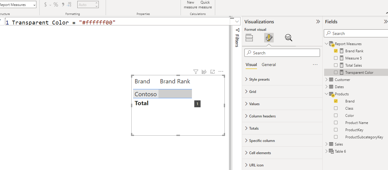

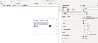

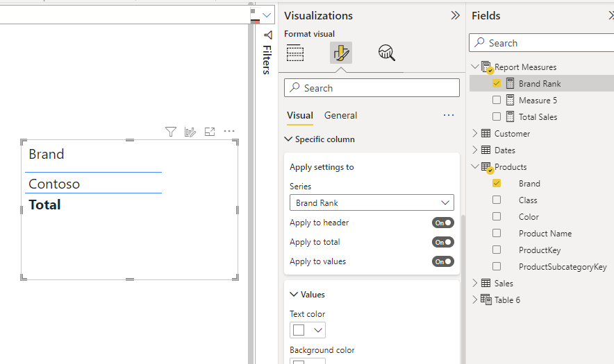

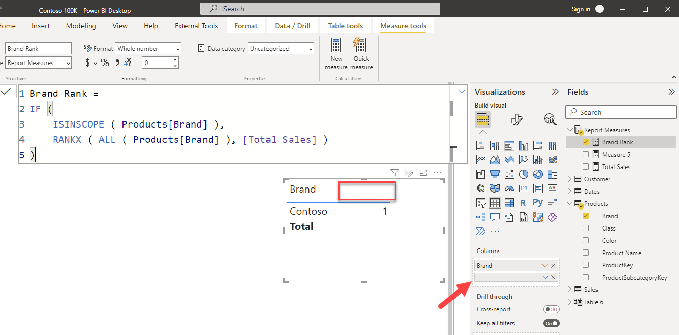

@adsa Measure in Filter Pane have a high penalty so try to avoid that.
You don’t need to use that measure in the Filter Pane instead of that drop it into matrix and just reduce the width of the column or use a transparent color to hide the values.
Method 1 - Rename column and make font white
Method 2 - Rename column and make font transparent
@AntrikshSharma Thanks for this.
I will give this a try on my main file. Can confirm this works on the test file.
