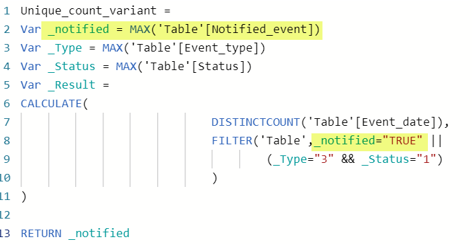

When I ran the above variant, it returned a different number. When I debugged the [Variant Unique count], I found that it also returns rows with Event_type value = 1 which was not the case. I am not sure why is returning 1 value. Is it because I used MAX() function. Could anyone help me about this behavior? I have uploaded the sample file.

@leo_89,
Given that it’s 2:30 AM in India, I’ll attempt to pinch-hit for @AntrikshSharma.
It’s the highlighted portions below giving you trouble.
Keep in mind that cards do not have any inherent evaluation context. Therefore, in a card MAX( Table[Notified_event] ) is always going to evaluate to TRUE (the max value of the entire column). Thus, in your filter condition you are saying to filter based on TRUE = TRUE OR (some other condition). Given that TRUE will always be equal to TRUE, you never get to the second condition (which by the way would have the same problem if you did get to it), and thus the measure always returns the value of DISTINCTCOUNT(Table[Event Date] ) over the entire (i.e., unfiltered) table = 1463.
