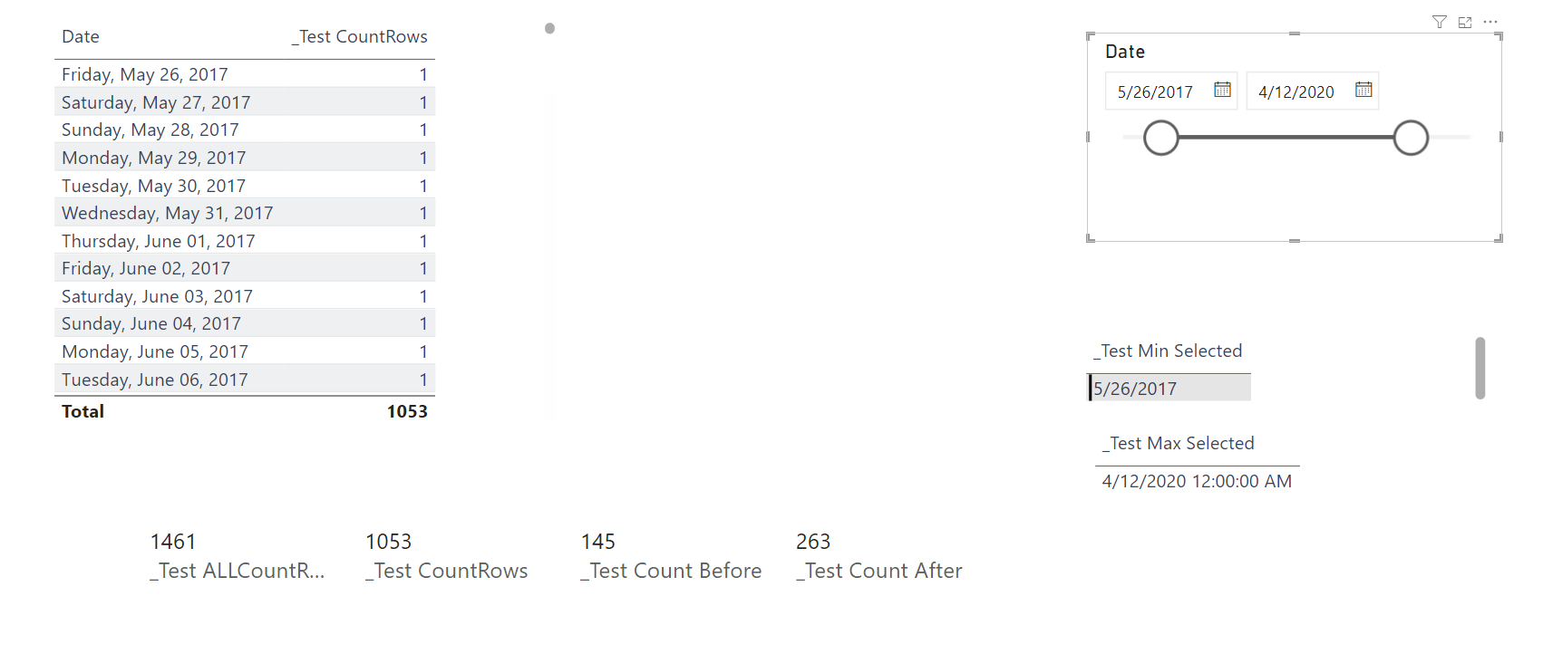

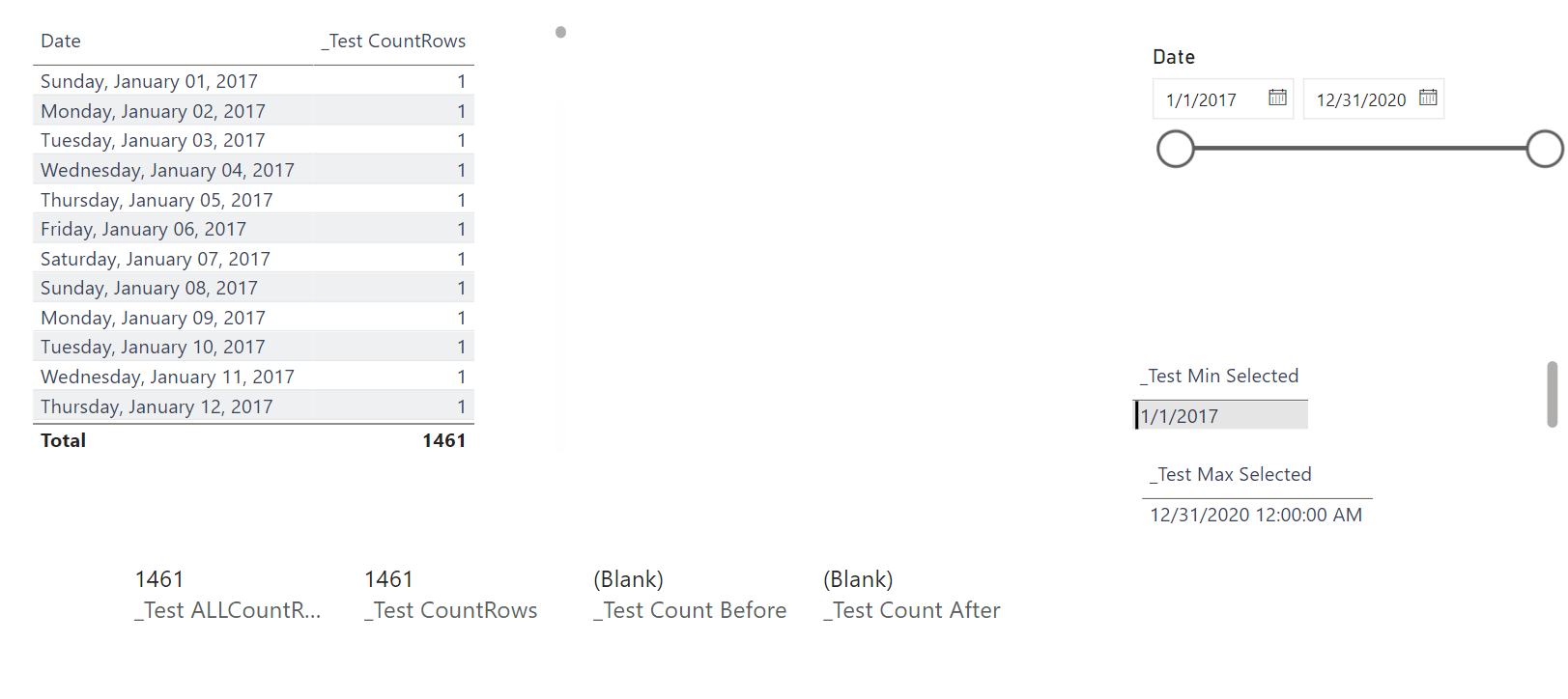

I found some sample dataset - my Dates are / Initial Set
if I move the date slicer - _Test_Count before and _Test Count After will be calculated
for Example:
so I used
_Test Min Selected = MINX(ALLSELECTED(dim_Calendar[Date]),dim_Calendar[Date])
What is the minimum Date of selected Date slicer ?
_Test Max Selected = MAXX(ALLSELECTED(dim_Calendar[Date]),dim_Calendar[Date])
What is the maximum?
For All Rows (despite what are you selected)
Test ALLCountRows = CALCULATE(COUNTROWS(dim_Calendar),ALL(dim_Calendar))
Simple calculate COUNTROWS for All (what you find in dimension Calendar)
For Count what is in selected period:
Test CountRows = COUNTROWS(dim_Calendar)
What is before :
Test Count Before =
VAR _Min =[_Test Min Selected]
VAR _Result=
CALCULATE (
    [Test CountRows],
    FILTER( ALL(dim_Calendar),
   dim_Calendar[Date] < _Min
Return _Result
Calculate COUNTROWS but you need to change context of calculation - filter so you use all calendar table (all dates) and filter where Date < Minimum Selected
For Counts After:
Test Count After =
VAR _Max =[_Test Max Selected]
VAR _Result=
CALCULATE (
    [Test CountRows],
   dim_Calendar[Date] > _Max
Return _Result
similar syntax is use just Date > _Max is changed
Please note that
Test ALLCountRows =Test CountRows+Test Count Before +Test Count After
Hope that is what are you looking for
