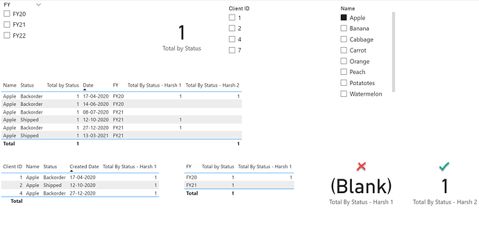

Hi All ,

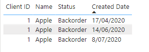

The above table shows Client 1 requested a backorder for Apples on 3 x Different dates.
I want to showcase the count as 1 using use relationship on the created date but only for the first date (i.e-17/4/2020)
My Measures:
Total Count = DISTINCTCOUNT('Data'[Name])
Earliest Count = VAR Products_Ordered =
    SUMMARIZE( 'Data', 'Data'[Status], 'Data'[Name],'Data'[Created Date] )
VAR First_Entry_Products_Ordered =
    ADDCOLUMNS(
        Products_Ordered,
        "Earliest Created Date", MIN( 'Data'[Created Date] )
VAR First_Entry_Products_Ordered_By_Min_Date =
    TREATAS(
        First_Entry_Products_Ordered,
        'Data'[Status],
        'Data'[Name],
        'Data'[Created Date],
        'Dates'[Date]
VAR Result =
    CALCULATE( [Total Count], First_Entry_Products_Ordered_By_Min_Date )
RETURN
    Result
Total by Status = VAR Filt =
    FILTER( 'Data', 'Data'[Status] IN { "Shipped", "Backorder" } )
RETURN
    CALCULATE(
        [Earliest Count],
        Filt,
        USERELATIONSHIP ( 'Dates'[Date], 'Data'[Created Date] )

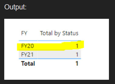

Output:
Expected Output:

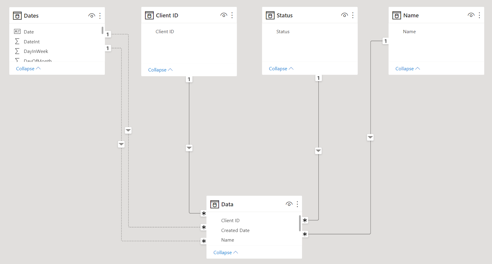

Should only show the value for FY20 as the first date is 17/4/2020
I think it has something to do with the date context of my measure but can’t seem to figure out where to resolve it.

@Harsh Thanks for the solution and it does work well, however have run into 1 minor issue.
The measure works well when there are slicer selections. However if there are no selections it come up with blank. What I am trying to do is showcase it on a card visual for just backorder.
I understand that because we are utilizing the ‘Selectedvalue’ function, it expects a value to be passed through in this case the ‘Client ID’ slicer.
Writing this measure does not help as it is still expecting a selectedvalue form the client id slicer .
Backorders =
CALCULATE (
    [Total By Status - Harsh],
    FILTER ( Data, Data[Status] = "Backorder" )
@jafernandezpuga Agreed!

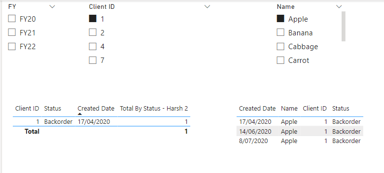

This measure will provide the result even though there’re no selections into the slicer. Below is the screenshot of the final results provided for the reference -
I’m also attaching the working of the PBIX file for the reference.

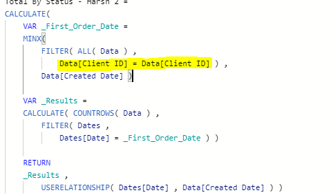

@Harsh Thanks for that. I’ve tried to implement the the exact same measure context into my live model however I now get a blank value.
On further debugging the issue is around here (See highlighted). It is not getting the current clientID and as a result it takes the minimum date across the entire table.
Intrestingly if i explicitly provide a client id it works for just that client id.

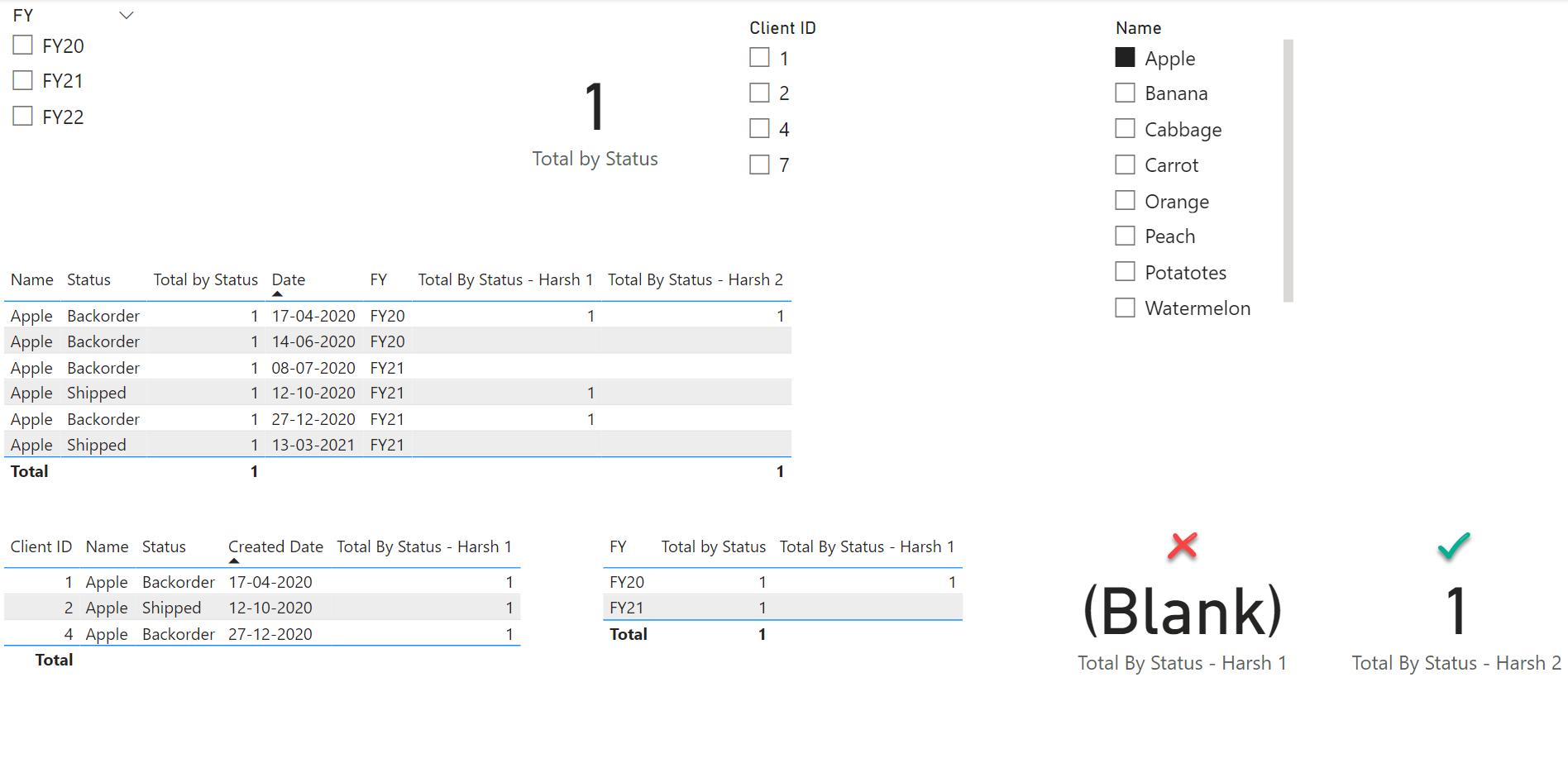

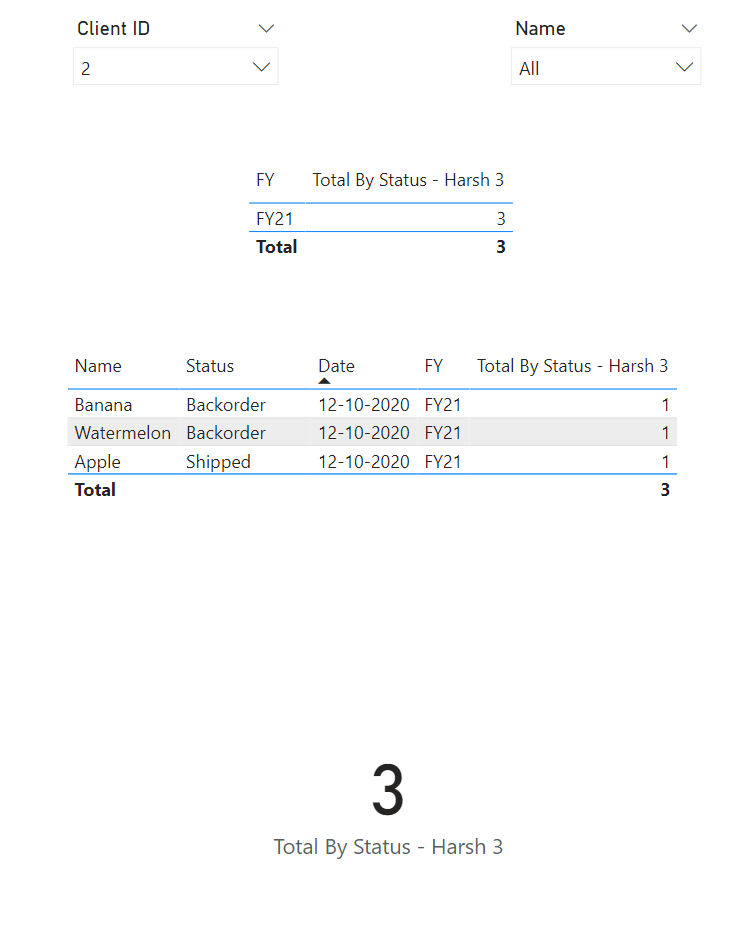

So inside a measure, the condition’s states that - “If a slicer selection is made then evaluate the results based on that or else provide the minimum results of all time.

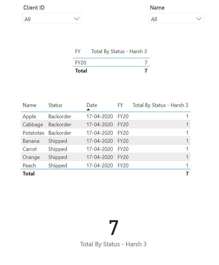

1). Results when slicer selection IS NOT made -
As said above, when slicer selection is not made, it’ll consider the minimum date from the beginning of the time and provide the results.
2). Results when slicer selection IS made -
So now, I don’t see the results as “BLANKS” anywhere except where the status is “Processing” or “Created Date is not equal to Minimum Date”.
I’m attaching the PBIX file as well as for the reference.

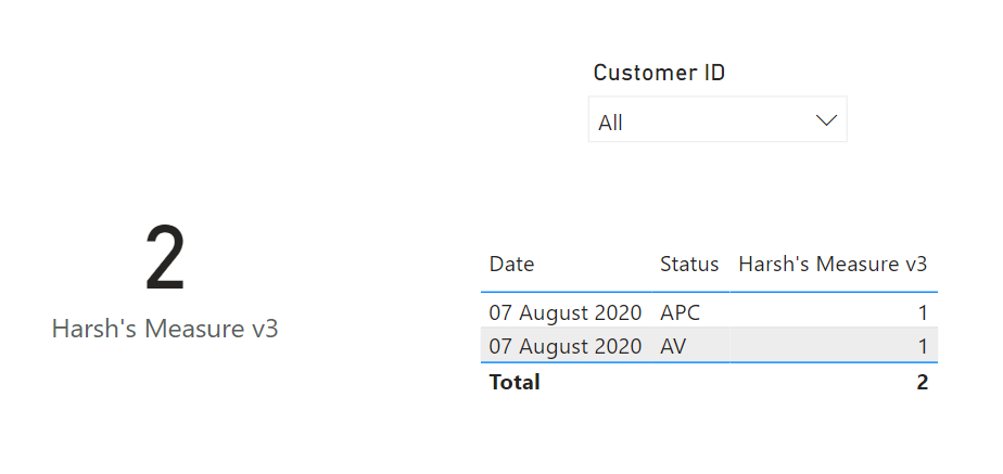

@Harsh
I have prepared a sample set and applied your measure v2 to showcase the issue
Sample Set.xlsx (18.9 MB)
Sample PBI.pbix (8.8 MB)
I will review v3 of your measure shortly.

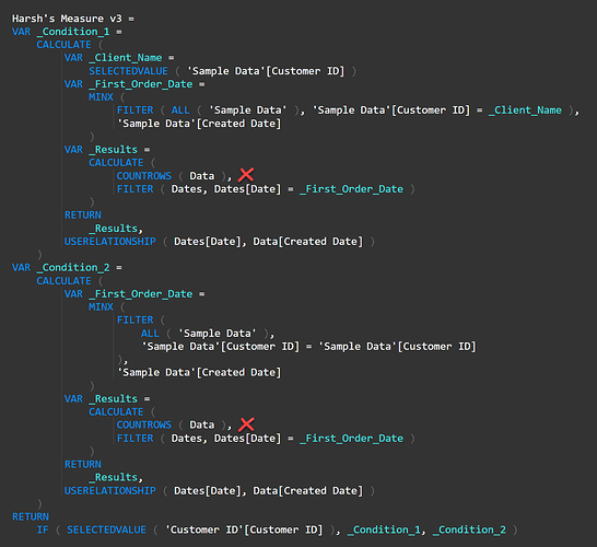

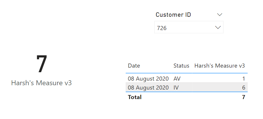

@harsh Implemented v3 of your measure in the sample data set i recently provided, still not having any luck. I’m looking to obtain the minimum date by customer ID & Status This is the measure i wrote:
Harsh's Measure v3 =
VAR _Condition_1 =
CALCULATE(
    VAR _Client_Name =
    SELECTEDVALUE( 'Sample Data'[Customer ID] )
    VAR _First_Order_Date =
    MINX(
        FILTER( ALL( 'Sample Data' ) ,
            'Sample Data'[Customer ID] = _Client_Name ) ,
        'Sample Data'[Created Date] )
    VAR _Results =
    CALCULATE( COUNTROWS( Data ) ,
        FILTER( Dates ,
            Dates[Date] = _First_Order_Date ) )
    RETURN
    _Results ,
        USERELATIONSHIP( Dates[Date] , Data[Created Date] )  )
VAR _Condition_2 =
CALCULATE(
    MINX(
            'Sample Data'[Customer ID] = 'Sample Data'[Customer ID]
    VAR _Results =
        FILTER( Dates ,
    RETURN
    _Results ,
        USERELATIONSHIP( Dates[Date] , Data[Created Date] ))
RETURN
IF( SELECTEDVALUE( 'Sample Data'[Customer ID] ) ,
    _Condition_1 ,
    _Condition_2 )
Output:

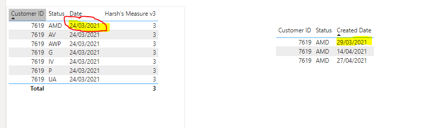

@Harsh in the original dataset your measure v2 worked when i placed it in a table.
I then posted a second dataset and used your v2 measure but can’t get it to work.
1st Dataset: client id > 2nd Dataset: customer id
1st Dataset: Status> 2nd Dataset: status
Just want to understand why the measure doesn’t work in the 2nd dataset?

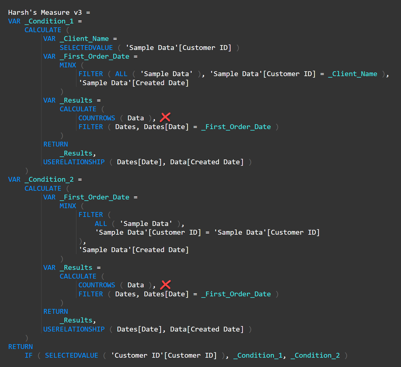

Hello @adsa,
So you’re suggesting that “Measure Version 3” is also not working.
The reason why it’s not working is because you’re referencing two different tables inside the measure. See this -
Since you want the results based on a “Sample Data” table then why “Data” table is getting referenced inside this measure? Also in my previous file I had created couple of dimension tables. In your new file, you haven’t created that as well.

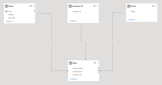

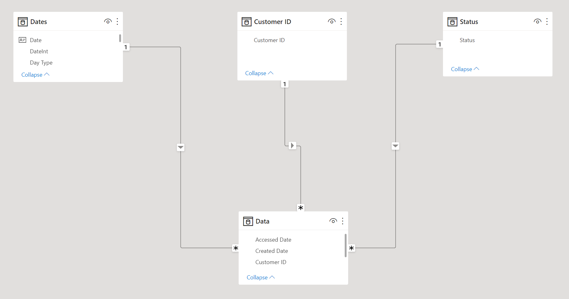

I created a new PBIX file based on the new dataset that you’ve provided to see whether my “Measure Version 3” is working or not. And it’s working absolutely fine!!!
Firstly, you’ll be required to convert your flat file into a proper data model. Below is the screenshot of the data model provided for the reference -
Now, use that “Version 3” measure. Below is the measure again provided for the reference -
VAR _Condition_1 =
CALCULATE(
    VAR _Client_Name =
    SELECTEDVALUE( Data[Customer ID] )
    MINX(
        FILTER( ALL( Data ) ,
            Data[Customer ID] = _Client_Name ) ,
    VAR _Results =
        FILTER( Dates ,
    RETURN
    _Results ,
VAR _Condition_2 =
CALCULATE(
    MINX(
            Data[Customer ID] = Data[Customer ID] ) ,
    VAR _Results =
        FILTER( Dates ,
    RETURN
    _Results ,
RETURN
IF( SELECTEDVALUE( 'Customer ID'[Customer ID] ) ,
    _Condition_1 ,
    _Condition_2 )

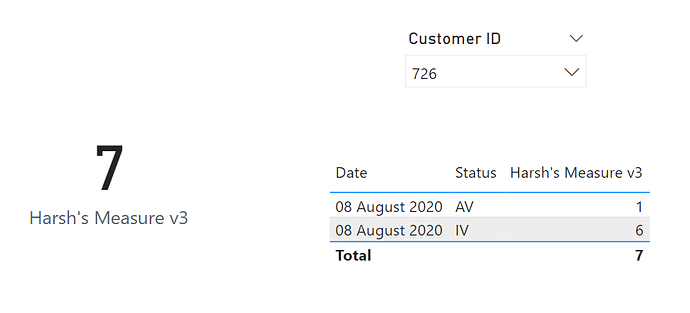

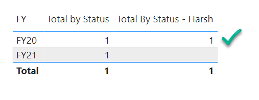

And now, if you see, it’s evaluating the results when slicer selection is made and even when slicer selection is not made. It’s even evaluating the results inside the cards as well so I’m not getting any results as Blanks from my side. Below is the screenshot provided for the reference -
I’m also attaching the new working PBIX file for the reference based on the new dataset which was provided.
