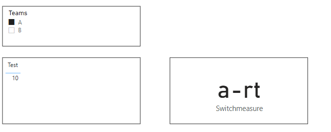

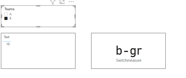

Thanks for the time @jafernandezpuga the switch seems to default to the last value of nothing been selected, although I am sure that the switch function returns the expected value on its own
test.pbix (107.7 KB)
Hi @akeko,
Since this is a dynamic calculation that depends on the value that we select in the report, we have to create the table in a measure and return the sum of the column, instead of creating the table in the model.
The measure is called Total Test.
Greetings,
Regards,
test_JAFP.pbix (108.0 KB)
