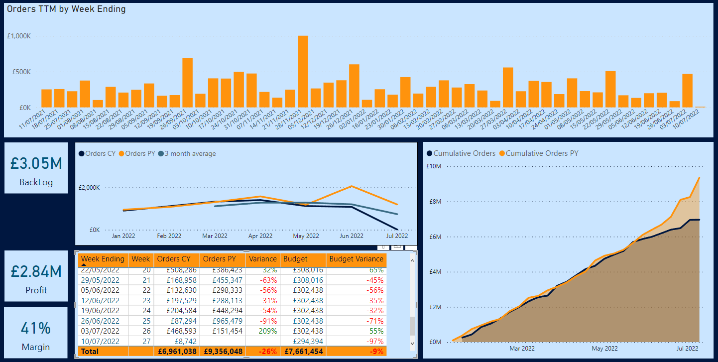

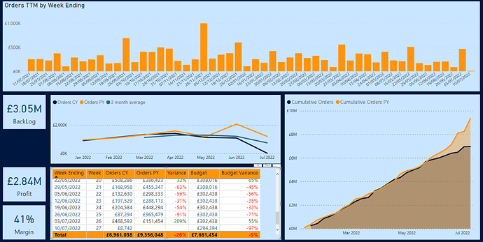

I have created a report that in the top visual, shows sales orders from the current week ending -365 days to the current week.
Here is the measure:

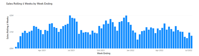

The report was received well, but I have been asked to modify it to show the the sum of the rolling 4 week value.
I created the following measure to accomplish this.
Sales Rolling 4 Weeks =
VAR Weeks =
    DATESBETWEEN (
        'Date'[Week Ending],
        MAX ( 'Date'[Week Ending] ) -21,
VAR Result =
    CALCULATE ( [Total Sales], Weeks)
RETURN
    Result

The issue I have, is trying to restrict the values to the previous 12 months.
I managed to fix it using an additional date table, but this was causing other issues, and I really dont think this was the way to proceed?

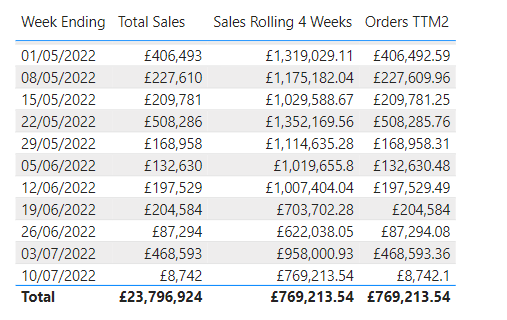

I also tried combining the two measures, but this caused the rolling 4 weeks to stop working.
Orders TTM2 =
CALCULATE (
    [Sales Rolling 4 Weeks],
   FILTER(
        'Date',
        'Date'[Date] >= TODAY() -365 &&
        'Date'[Date] <= MAX('Date'[Date])
pbi3
Could anyone point me in the right direction please?

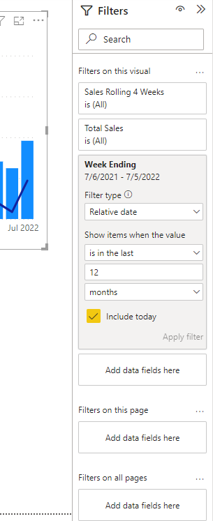

Before I dig too deep into this, I was able to get a simple filter to zero in, does this get you what you need?
Thanks for the reply.
Ideally, I’d like to do it in DAX if possible?
I don’t want any slicers, or visual filters on this report.
Kind Regards,
Mark
