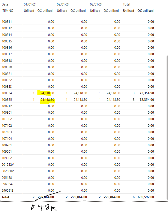

That works! Thanks. Can I ask you to have a look at just one more measure? I need to use the âOC Newâ as the basis for a new measure but only needs to sum the items that have a greater than 0 utilisation. I have created the measure âOC utilisedâ, but is not working.
sample data.xlsx (64.0 KB)
sample.pbix (140.9 KB)
