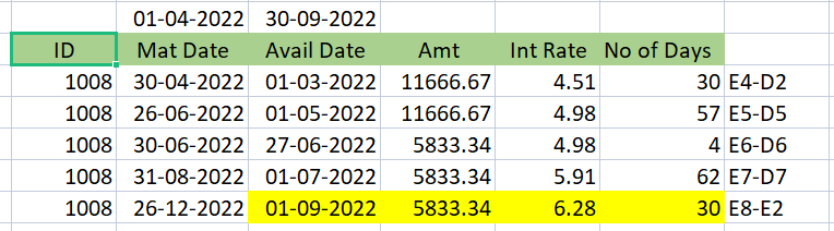

Hello All,
I have the Fact Table Data in the below format.
I created a Date Table
Date Table = calendar(DATE(2020,04,01),DATE(2023,12,31))
And Relationship is like
Active Relationship between Fact[Mat Date] - Date Table[Date]
InActive Relationship between Fact[Avail Date]- Date Table[Date]
My scenario is
I have Start Date (01-04-2022) and End Date(30-09-2022) as date Filter from Date Table and
I will be getting 4 rows with my selection, to get Yellow Highlighted row(5 th row)
I created a measure using the DAX
Availed Date =
var a = CALCULATE(MAX(Fact[Avail Date]),USERELATIONSHIP(Fact[Avail Date],Date Table[Date]))
var b = MAX(Fact[Avail Date])
return
IF(ISBLANK(a),b,a)
I’m getting correct result with the above DAX.
The same logic for Amt
Amt =
var a = CALCULATE(SUM(Fact[Amt]),USERELATIONSHIP(Fact[Avail Date],Date Table[Date]))
var b = SUM(Fact[Amt])
return
IF(ISBLANK(a),b,a)
I should get the Total 40833.6 but I’m getting 29,166.69 (Total- It’s excluding the first row i.e, 01-03-2022).
SUMX = SUMX(VALUES(Dim[ID]),[Amt]) This is giving 35000.06 as Total but Last row is Blank.
Here’s the Link for the pbix File
Wrong Totals with Userelationship.pbix (60.2 KB)
@Harsh
Can anyone suggest the alternative for this!!!
TIA

Hi @likhitha - Try this measure
Total Amount = var Avail = CALCULATETABLE(sheet2,USERELATIONSHIP(‘Date Table’[Date],Sheet2[Avail Date]))
var Mat = CALCULATETABLE(Sheet2)
return
sumx(DISTINCT(union(Avail,Mat)),Sheet2[Amt])
Attached PBIX
Wrong Totals with Userelationship.pbix (60.3 KB)
Ankit J
Hi Ankit…
It worked out Perfectly.Thank you so much for the response :slight_smile:
I got the solution with the below approach.But yours pretty straight forward.
Flag =
var a = MAX(‘Date Table’[Date])
var b = CALCULATE(MAX(Sheet2[Mat Date]),USERELATIONSHIP(‘Date Table’[Date],Sheet2[Avail Date]))
return
IF(b>a,1,0)
2.Derived Amt for the Flag output if it’s 1.
Amt_Last Row =
var d = CALCULATE(SUM(Sheet2[Amt]),USERELATIONSHIP(‘Date Table’[Date],Sheet2[Avail Date]),Sheet2[Mat Date]>=a)
return
IF([Flag]=1,d)
3.Then Added the Amt from Fact Table with Step 2 Result.
Amt_Result =
var a = [Amt_Last Row]
var b = SUM(Sheet2[Amt])
return
a+b
