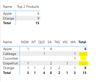

I’m using the TOPN DAX function in a measure that shows the correct result when it is placed in a table.
When i place the measure in a matrix and add a column it shows all values (Including blankls) how would i apply the filter context to the column as well?
Not looking for a solution as such but any information so I can read and apply would be appreciated.

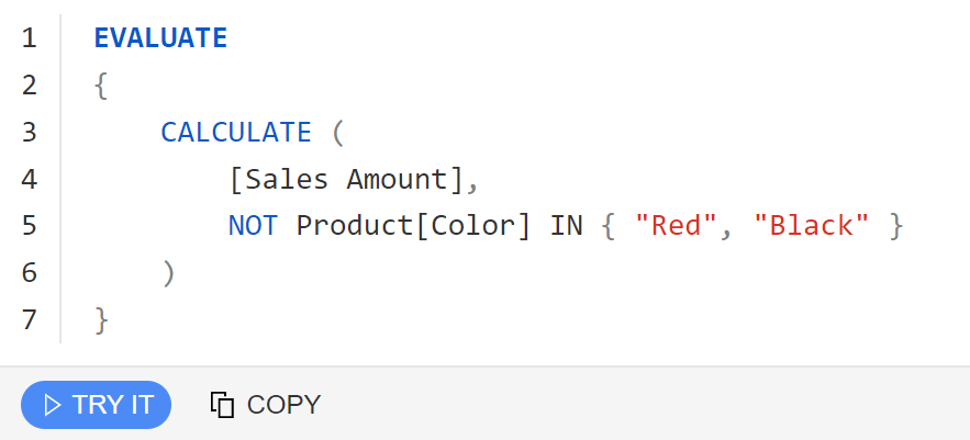

This one is tricky to debug – I’ve attached a solution, but if you want to work through it on your own, the hints I would give would be to check the context of your Top2 table, and also to look at the IN operator (SQL BI has an excellent article on this).

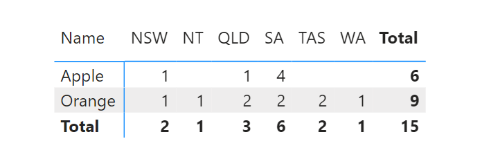

I’m assuming this is the outcome you’re looking for:
I’m sure there’s a simpler way to code this, but the attached solution file contains the DAX code to achieve this result.
