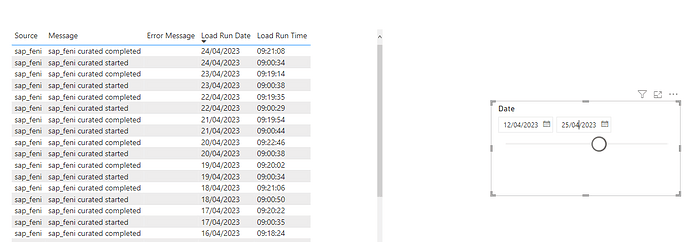

I would like to get the last 7 days of loads as per table below.
As you see I have started the DAX but not sure if this is the right thing to do and if it is why it does not work.

Yes, I am now doing what you suggested with a filter for date.
Now that I have the filter for date, How can I set the end date to be today?
for example

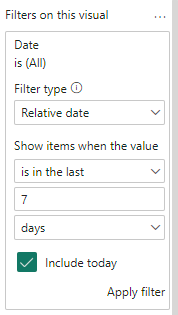

You can either add the date filter as a visual level filter or as a page level filter and set it like the image below. Your choice is whether you want “Include today” ticked or not.
Add a filter to a report in Power BI - Power BI | Microsoft Learn
Untick “Include today”
