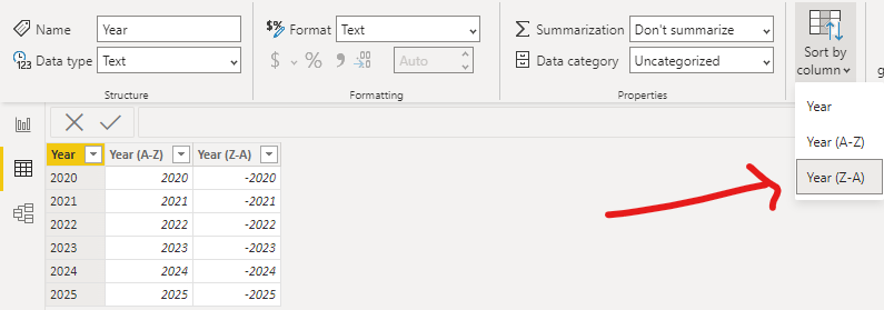

I have a requirement where user has asked to sort year column that appear in filter pane to show present year as first one in the list. i.e Descending order. I was unable to do it with sort by column option ( like i was able to sort month as jan, feb and so by using sort by column month number) Is there any way to achieve it.

You can’t change the sort order within the Filter Pane, so it has to be set Descending by default. See if this works for you.

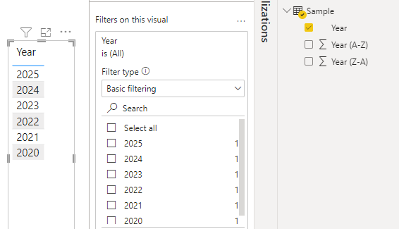

Don’t know if there’s a better way but this does do the trick for you, if you limit the years to the current one that is…
I hope this is helpful
I Dont see the year(Z-A) or year (A-z) options in the sort by column. , Also our data has only upto this year ie 2022, 2021, 2020 …, Any Calculated column will help to sort the year?
Apologies if my previous response was unclear. I created those sort by colums both are of type number, the A-Z is equal to the value of the year and the Z-A is the negative value of the year.
Here’s my sample.
