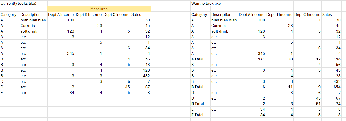

I’ve been asked to setup a table that has a sub total after every department, which I don’t currently know how to do.
I tried this with a Matrix, but they don’t want the items measure to be repeated per department too, just shown once at the end in the column totals.
Is this possible? see pbix file

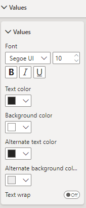

To do so first you need to
Remove wrap text - both for Values and headers
Then just shrink the value fields per departments until it is hidden.
Example:
