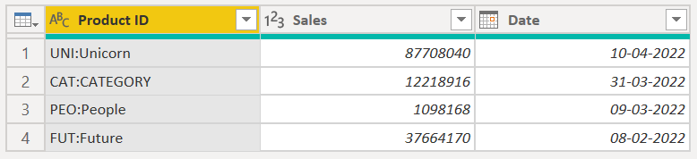

I hope my image provides the correct info of what I am attempting to do.
Data set contains duplicates in the Product ID column. I am required to keep the most recent $sales - hence the table.buffer which works fine, but when there are duplicates Product Id’s when sales are made on the same date, I am required to keep the highest $sales for that day so the Table.Buffer appears not to be the entire solution.

Hello @Cazvon,
Paste the below provided query onto the “Blank Query” and you’ll be able to see the results as expected. Below is the query alongwith the screenshot of the final results provided for the reference -
let
    Source = Table.FromRows(Json.Document(Binary.Decompress(Binary.FromText("dY4xC8IwFIT/S+aDvJfE5CWbSCsutkg7SOkkHQRppdj/b+OiIB1uOO7j7rpOlW2TyuW1zIOCsgHeO3Cg1ZBoMtqQMapHp+qiSvUwPR8ZZFAUsJfMRU32y7XnU2rH+22axzWUgEACcrmRSZPbIr3AWobw7p887Ju0qjhWl2tODQwLIvv8mfXmOkc48jCfn7+d/Rs=", BinaryEncoding.Base64), Compression.Deflate)), let _t = ((type nullable text) meta [Serialized.Text = true]) in type table [#"Product ID" = _t, Sales = _t, Date = _t]),
    #"Transformed_Data" =
        Table.Sort(
            Table.Distinct(
                Table.Sort(
                    Table.TransformColumnTypes(Source,{{"Product ID", type text}, {"Sales", Int64.Type}, {"Date", type date}}),
                {{"Product ID", Order.Ascending}, {"Date", Order.Ascending}, {"Sales", Order.Descending}}),
            {"Product ID"}),
        {{"Date", Order.Descending}})
in
    #"Transformed_Data"
