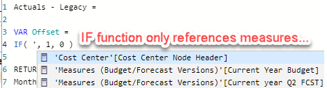

Hello Brian,
Makes total sense!
In trying to implement the solution, the “If” function is not letting me test any given Fiscal Time (the table) column – it only allows me to reference other measures. The only solution (work-around) I believe is to define a supplemental measure based on the Fiscal Month or Fiscal Offset columns, and then reference the supplemental measure within the “IF” statement — awkward. BTW, adding a calculated column is not an option, due to the nature of the source dataset.
