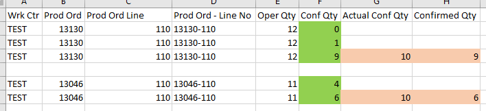

I’m having issues calculating the total confirmed quantity on a production order based on the largest production order line number.
The image above highlights 2 production orders. 13130 and 13046.
For Prod Ord 13130 the largest (or maximum Prod Ord Line) is 110. For this particular line number the confirmed qty shows as 0, 1, & 9, giving a total of 10 as seen in the Actual Conf Qty column, however my measure Confirmed Qty is returning 9
Likewise for Prod Ord 13046 the largest (or maximum Prod Ord Line) is 110. In this case the confirmed qty shows as 4 & 6, giving a total of 10 as seen in the Actual Conf Qty column, however my measure Confirmed Qty returns 9.
It would appear whenever we have multiple lines of a Prod Ord and Prod Ord Line, the measure only returns the maximum value in our case for Prod Ord 13130 = 9 & Prod Ord 13046 = 6. So how do we capture all the corresponding values of so that Prod Ord confirmed qty returns the correct values

I believe I have corrected my erroneous measure.
I changed the measure [Max Conf Qty] to the following: -
Conf Qty = SUM ( 'Conf Qty'[Conf Qty] )
Then updated the ADDCOLUMNS portion of the [Confirmed Qty] measure per the following: -
Was : “@ConfirmedQty” , [Max Conf Qty]
Is: “@ConfirmedQty” , CALCULATE( [Conf Qty] ) // [Max Conf Qty]
Confirmed Qty =
VAR _OpNo = MAX( 'Conf Qty'[Prod Ord Line])
VAR _ConfirmedQty =
SUMX(
    ADDCOLUMNS(
        SUMMARIZE(
            'Conf Qty',
            'Conf Qty'[Prod Ord],
            "@OpNo" , _OpNo
        "@ConfirmedQty" , CALCULATE( [Conf Qty] )   // removed [Max Conf Qty] and replaced with  CALCULATE ( [Conf Qty] )
    [@ConfirmedQty]
RETURN
_ConfirmedQty
Image below shows the correct result
