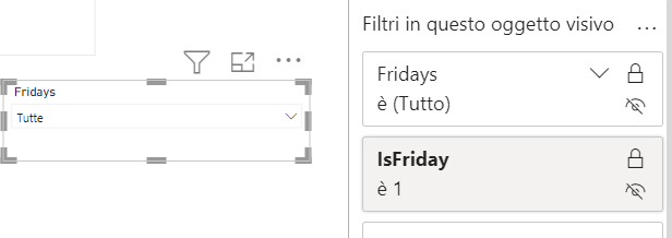

I cancelled the OnlyFriday table and added a column in the date table which tells whether is friday or not in order to recreate the slicer you wanted and then I fixed the relationship between financial period and date table.
Now you can slice by financial period; financial period empty values are those periods which do not have a corresponding date in Dates table.

In order to tag only friday days just create a calculated column in date table like I did in the .pbix and just use it to filter the slicer.
