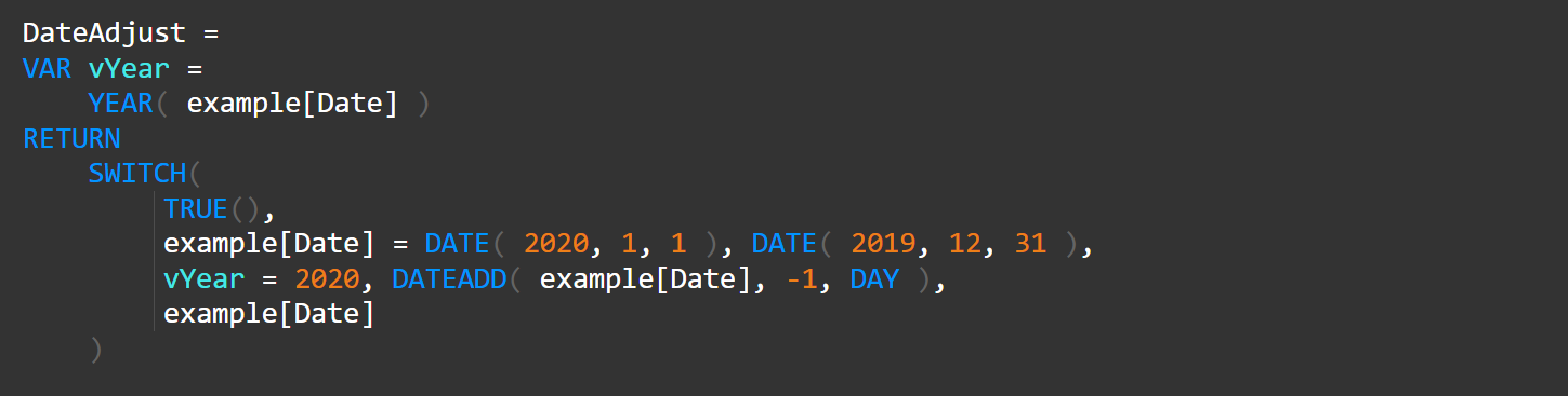

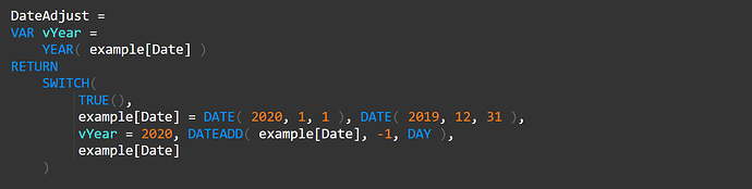

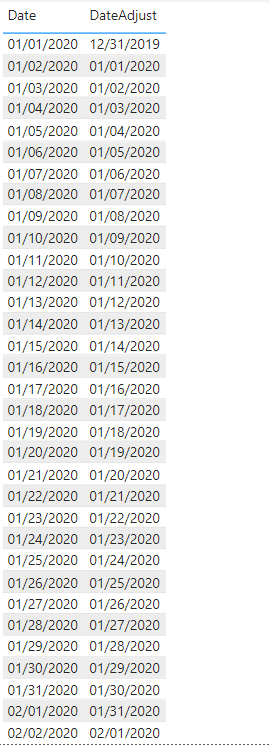

Hi @pete.langlois
Create a calculated as below
Thank you so much for that detailed answer @Rajesh
