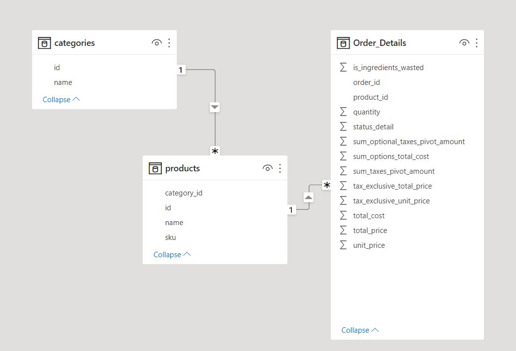

Thank you @AntrikshSharma , here is a resources (Data)
https://drive.google.com/file/d/1GAsT46vs0H-he0MBsVqNsTziW62qspb6/view
The schema on the screen-shot , U can Just use the measures available on the Pbix I submitted it on my previous replies , the scenario we my use it , Simple table (Not matrix) , Top 10 Combination of measure (Orders Both products) for Product Key (And product table) with Key in (Products table) similar to the one on Daxpattern , appreciated your help.
I hope and looking for your kind response.
Note: For the data is masked in Products table (Product 1,2, …X) and any one can benefit from it because it represent a real data but (Masked).
