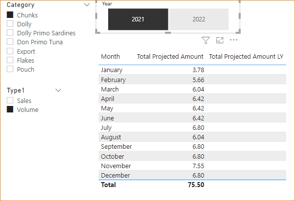

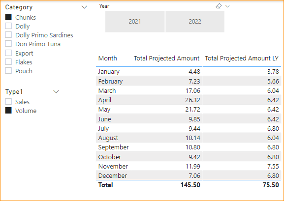

Hi,
I want to show the previous year projected value based on the current filter context selected, but the SAMEPERIODLASTYEAR measure is blank.
When I unselect the Year slicer, its working ok.

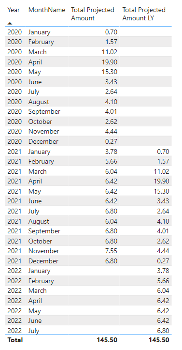

The thing is that your fact table (Projected Data) and Date table do not match in terms of the Date column. You have data for 2020 and 2021 in your fact table, but the Date column in the Dates table is from 2021 to 2024. So, the first thing to do is to correct the Date column in the Dates table to be started from 1/1/2020 instead of 1/1/2021.
The other thing is that I noticed you placed the month in the table visualization from your fact table. I highly recommend you to use filters from your Lookup (Dimension) tables. I replaced that column with the MonthName from Dates table and added the Year column to the viz to be more clear.

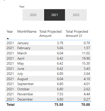

Below you can see the data for the Current & Previous years.
And by filtering 2021 using the slicer, you’ll receive the following:
If you select 2022 in the slicer, you’ll just see the Total Projected Amounts for LY because you don’t have any value for the 2022 year in your fact table.
