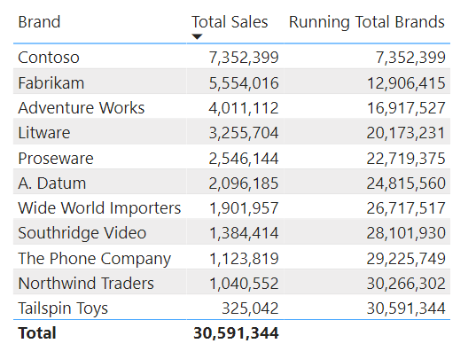

The Running Total function over text values becomes even more interesting if there’re multiple Brands with the exact same values.
Please have a look at this example with a small change - two new Brands (Company A, Company B) with same Total Sales (500k) have been added. In that case, our Running Total doesn’t recognize the increments from identical values, it simply repeats them instead of adding them up.
Is there any workaround for this issue**?** Thank you so much for a solution. Best regards, Rafal
The measure I used is as follows:
RT Brands =
VAR CurrentBrandSales = [Total Sales]
RETURN
SUMX(
FILTER(
SUMMARIZE( ALLSELECTED( fSales ), dBrands[Brand ID],
“@Sales”, [Total Sales] ),
[@Sales] >= CurrentBrandSales ),
[@Sales] )
