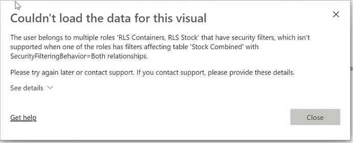

I’m hoping this image provides enough detail. Experiencing an issue in a published report that has RLS in two different tables that are linked through a ‘Bridge table’.
Can someone translate what this error message is trying to tell me please? This report has been working for quite some time and I’ve not made any changes so unsure why this is occuring now.

Hi @DavieJoe
Found a similar issue on Internet that is also raised recently. It seems there are some feature changes at Power BI that is causing this issue for multiple users.
Please go through below post for more information and help.

Update for anyone experiencing this.
I have a link/bridge table connecting the two tables which both contain RLS, moved the RLS into the link table (removed RLS from the other two tables) and working fine again.
