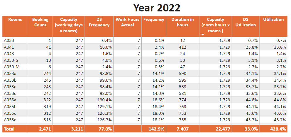

  1. Added a measure for the calculation of the day capacity of the rooms
    Capacity (working days x rooms) = // days, excluding given holidays, excluding weekends
    CALCULATE( COUNTA('Calendar'[Date]) * DISTINCTCOUNT( RRS_Data[Rooms]) ,
                    FILTER( 'Calendar', and(WEEKDAY( 'Calendar'[Date] ) < 6 , 'Calendar'[Date] <> RELATED( Holidays[Dates] )) ))
  2. Added a measure for the hour- capacity of the rooms, multiplying the day capacity with 7, which aligns with your calculated column “Work hours actual” (only on daily basis in Calendar) .
  3. Adjusted the Frequency calculation, which in my opinion should be based upon Days instead of hours, as the Booking Count is based upon days: each line in the RRS-Data-table has a different day-start date per room, with an actual daily booking, the total count of the RRS Data table are the actual days booked as far as I could analyse.
    DS Frequency = DIVIDE([Booking Count], [Capacity (working days x rooms)])
  4. Used just a different formula, with exactly the same outcome for Utilization:
    DS Utilization = DIVIDE (  SUM (RRS_Data[DurationInHrs] ), [Capacity (norm hours x rooms )],  0  )
  5. The reason why the Total of both Frequency and Utilization is not correct is that the denominator for the total, the calculated column “Work hours actual”, does not add up correctly in the context given.
    The Total for the denominator for both DS Frequency and DS Utilization is adding up as might be expected, and therefore counts correctly.
PS
  1. The daily capacity calculation can be checked in detail at page " Step 1 Capacity in days ", filter just on one room.
  2. The full capacity of all rooms is not calculated in this report, the Total Utilization is OVERSTATED, as the capacity is based upon the booked rooms, ( * DISTINCTCOUNT( RRS_Data[Rooms])), non-booked rooms capacity is missing. It is therefore better to calculate the capacity from a separate Lookup-table, listing all the rooms.
Some summary comparison within the table below:
