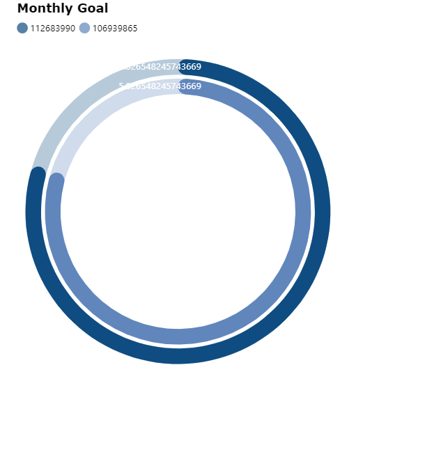

Hi DNA Enterprise,
I used the sample KPI Donut chart in your site and I want to recreate that one. But unfortunately the
Donut Chart.pbix (2.4 MB)
visuals that Im expecting is diffrent in what i have now
So for the legend I want to habe a total sales and total sales ly as legend not the actual value

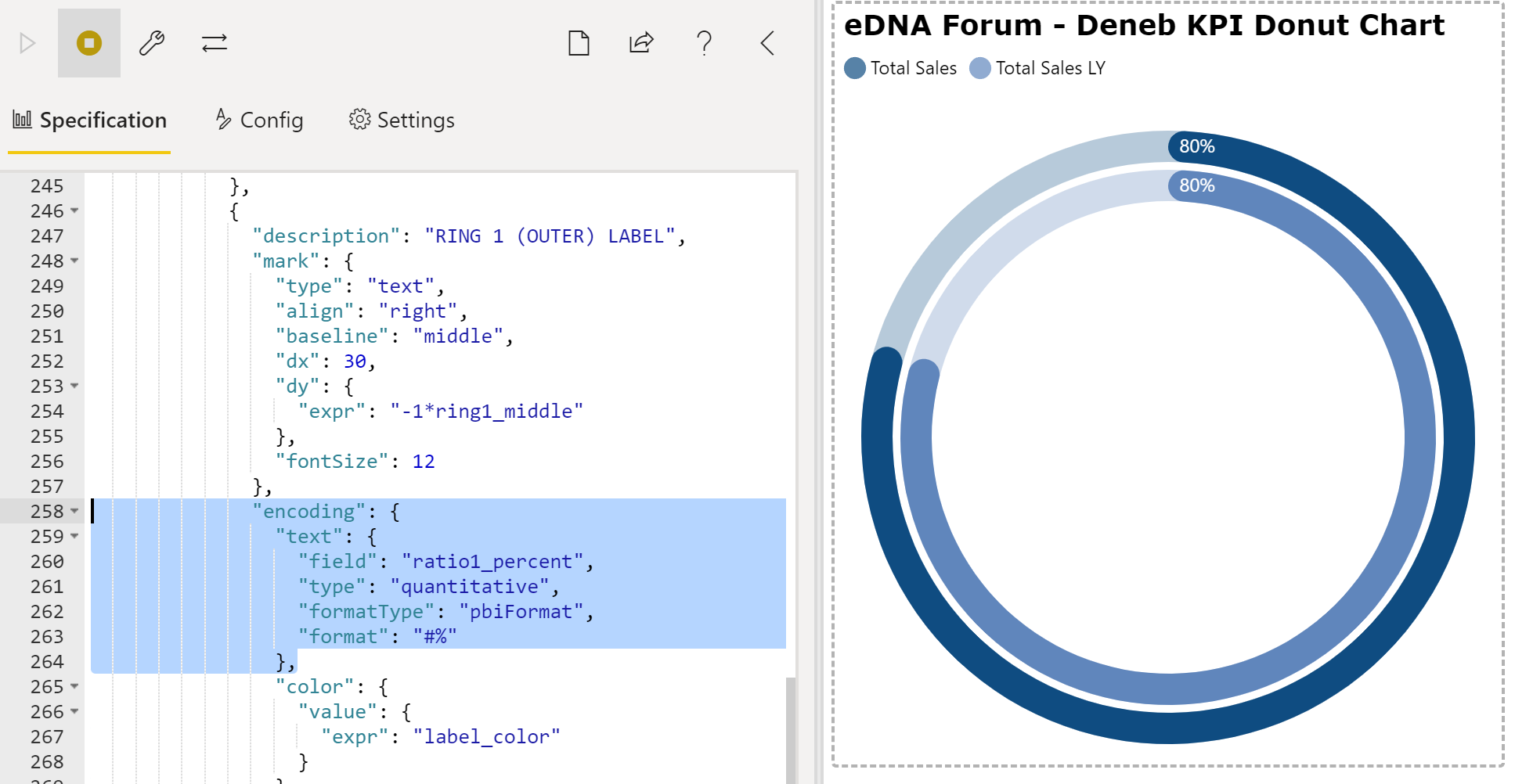

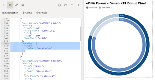

Hi @sgrady:
1 - Legend:
To use the value rather than the field name, change the text encoding to use “value” instead of “field”.

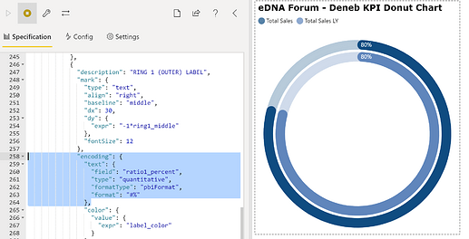

2 - Ring Labels:
To show your labels as percentages, you’ll need to adjust the field and formatting.
Hope this helps.
Greg
