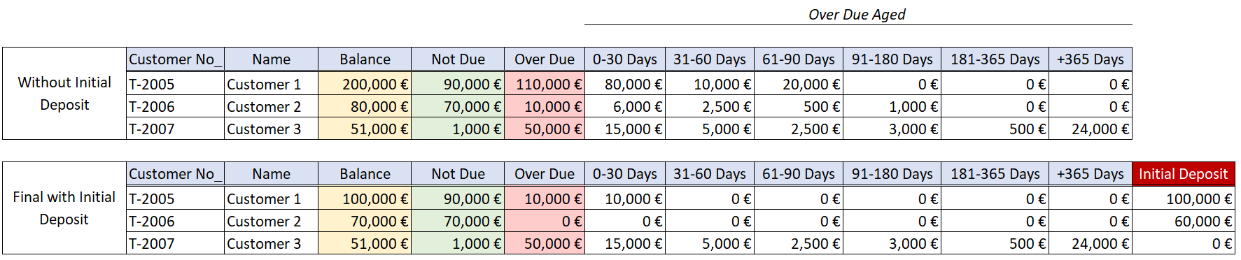

The final output I need is shown in the image:
Table 1– without applying the Initial Deposit.
Table 2 is the Final that I need – with the Initial Deposit applied as requested (if the balance is within the Initial Deposit value, it should display 0).
