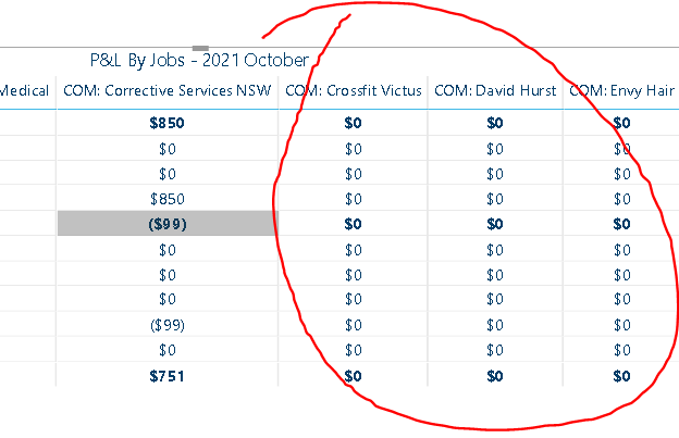

Hi @Melissa , thanks for taking the time on this. It does replaced the blank with zero, however, there were columns that appeared with zero values in it as you can see on the snapshot below. Thanks again!
Hi @Harsh , thanks for taking the time on this. It does replaced the blank with zeroes, however, columns appears with zero values as shown on the snapshot. Thanks again!
Hello @ronald_balza,
When you use this type of technique which is suggested by me and @Melissa the columns which were blanks earlier in it’s entirety will also come-up or start showing. So now, what you can simply do is drag or adjust the width of the columns and hide them which are un-necessary in your case.

@Harsh , thanks for taking the time on this. Much appreciated. Yeah you are right, because if I hide the columns then If there’s a value in it (since it is a moving data) then there’s no point in hiding it.
Hi @Melissa , thanks for taking the time on this. Really appreciated it. As per my understanding on your suggestion, it would be look like this? Still doing the same (appears the column with zero)
        P&L (No Blanks) =
               CALCULATE( IF( [P&L New] = BLANK(), 0, COALESCE([P&L New],0)))
