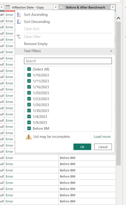

I am looking to replace my dates (any date in the column) to the word “After BM”.
Screenshot attached. Can you help?

Hi @judith_nigge is there some logic to Before BM?
Hi Davie,
Thanks for your quick reply.
“Before BM” is the replacement for all rows without dates - those ones gave an error. I copy the code here:
= Table.ReplaceErrorValues(#“Changed Type2”, {{“Before & After Benchmark”, “Before BM”}})
Now I need to change all dates to “After BM”. As I want them to appear as one only column in the visuals and not with different dates. I attach another screenshot:
Thanks for your help in advance!
Judith
Hi Judith,
try this step - adjust the previous step name and it should work:
= Table.ReplaceValue(prevStep, each [#"Before & After Benchmark"],each if [#"Before & After Benchmark"] <> "Before BM" then "After BM" else "Before BM",Replacer.ReplaceValue,{"Before & After Benchmark"})

@judith_nigge the solution @Matthias has suggested was what I was going to suggest. It should fulfill your needs if we’ve understood correctly.

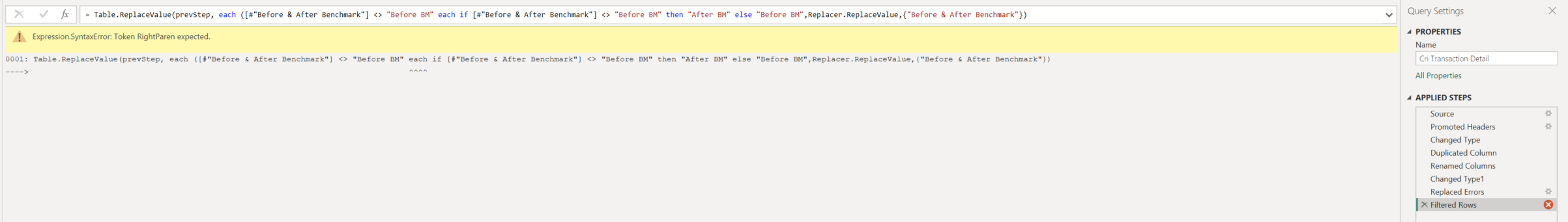

Hi Matthias,
I receive this error. I have tried to change it up, but cannot find the solution. Would you have another idea?
Hi Judith,
seems like a copying mistake. Could you try to copy the line once more in one portion.
And do make sure that to change the prevStep portion with Replaced Errors.
