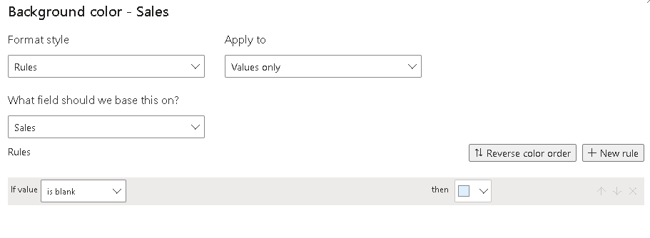

Hi @BCS,
if I correctly understood your question you do not need to replace blank with 0.
Just go to conditional formatting and add a rule to give a color to blank values like in the image:
Hope this helps.
Nicolò
