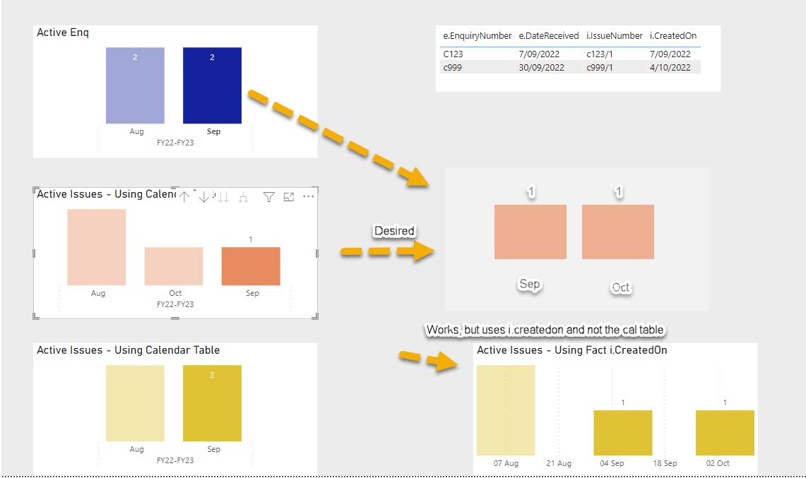

Hi Everyone,
I have a single entity, denormalised into that a single table containing Enquiries and Issues.
The denormalised entities would be a 1 to M (Enquiries as the one; Issues as the many)
The Goal
When you select a month that an active enquiry was received (date received), display all the related issues and display them on a timeline when they were created.
The Issue
When you select the particular enquiry date received month, it applies a filter to the model only for that month. However, some issues may have their i.createdon date in the following month, so PowerBi only shows the issues in the same enquiry month.
Progress so far
I have tried to remove the filter off the calendar table when writing the calculation and get the correct count, however, the timeline still only displays the initial filtered enquiry month.
i.e I click the timeline for September but there is one issue created in Oct (Oct doesnt appear on the timeline).
If I use the i.createdon date from the fact table, it works, but I know that is not best practice. Would appreciate any help to understand if what I am doing is the best way to do this and if it is possible.
Many thanks,

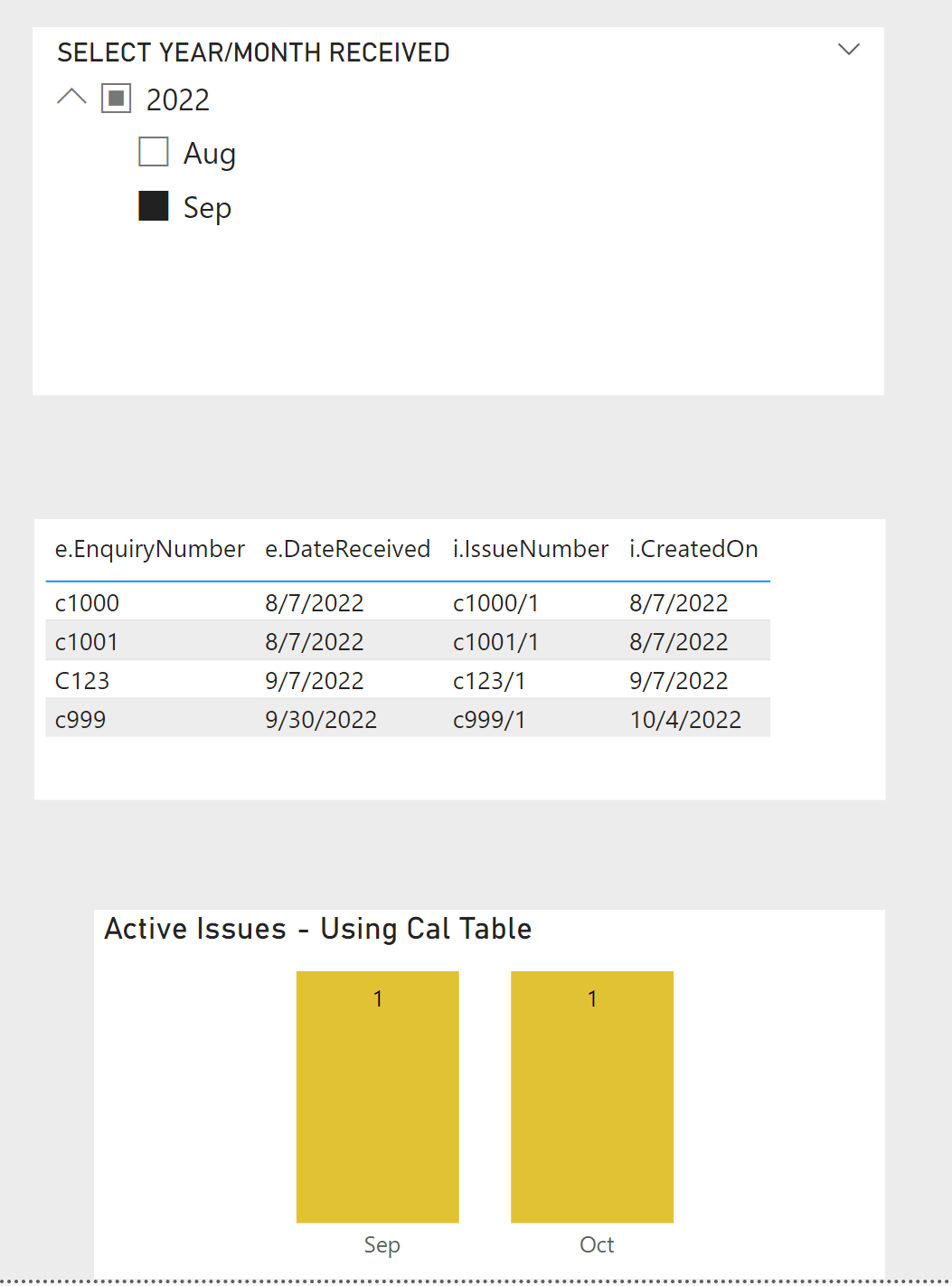

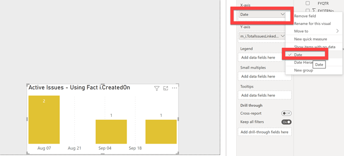

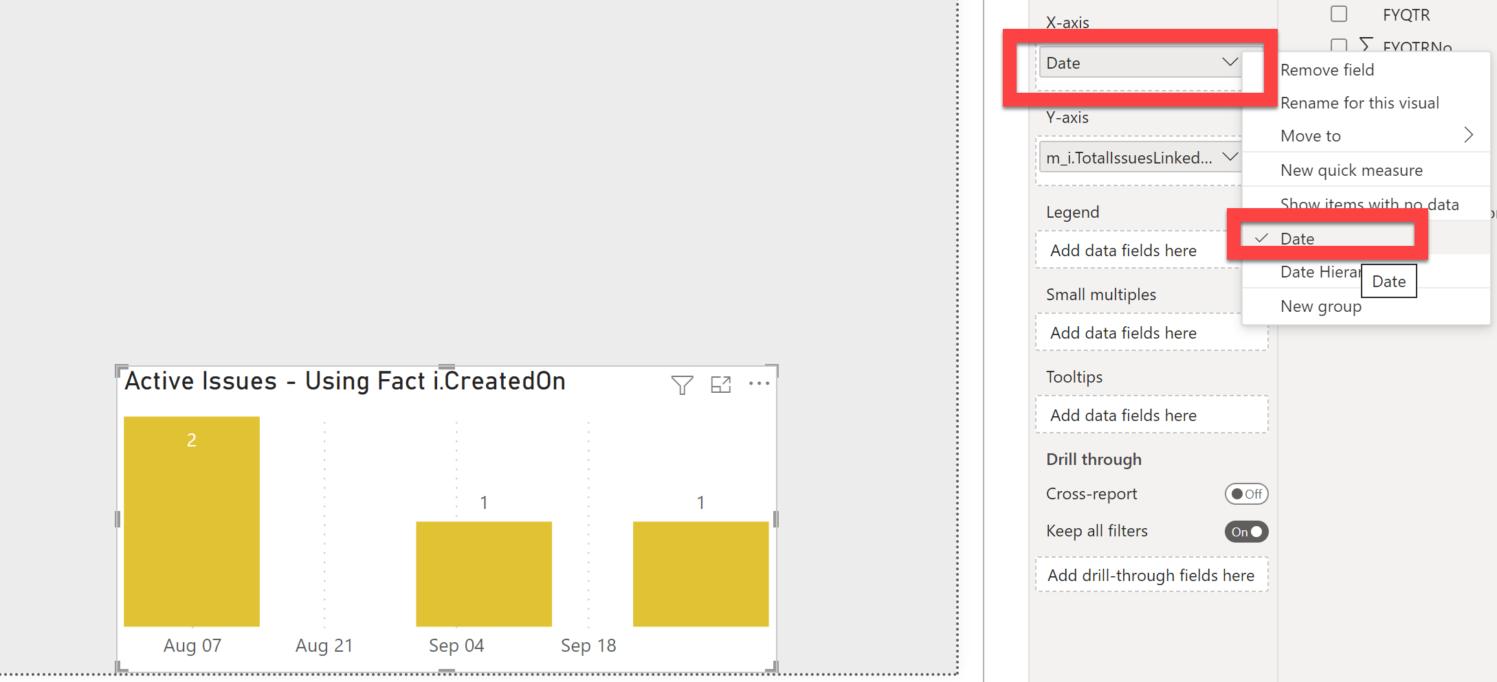

@AussieDragon ,
Is this the outcome you are looking for?
If so, you can obtain it without changing any of your measures or relationships, just by switching the date on the x-axis from the calendar table from hierarchy to date.
I hope this is helpful.
  • Brian
Hey Brian,
Thanks for taking a look - I dont think this works because it still doesnt represent the issue created in October: 4/10/2022… … If you look it still is using the enquiry date received values
In the measure, I thought it cleared any filter on the date table, but for some reason, it still has the filter on the month of September…
AD

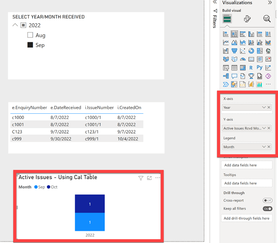

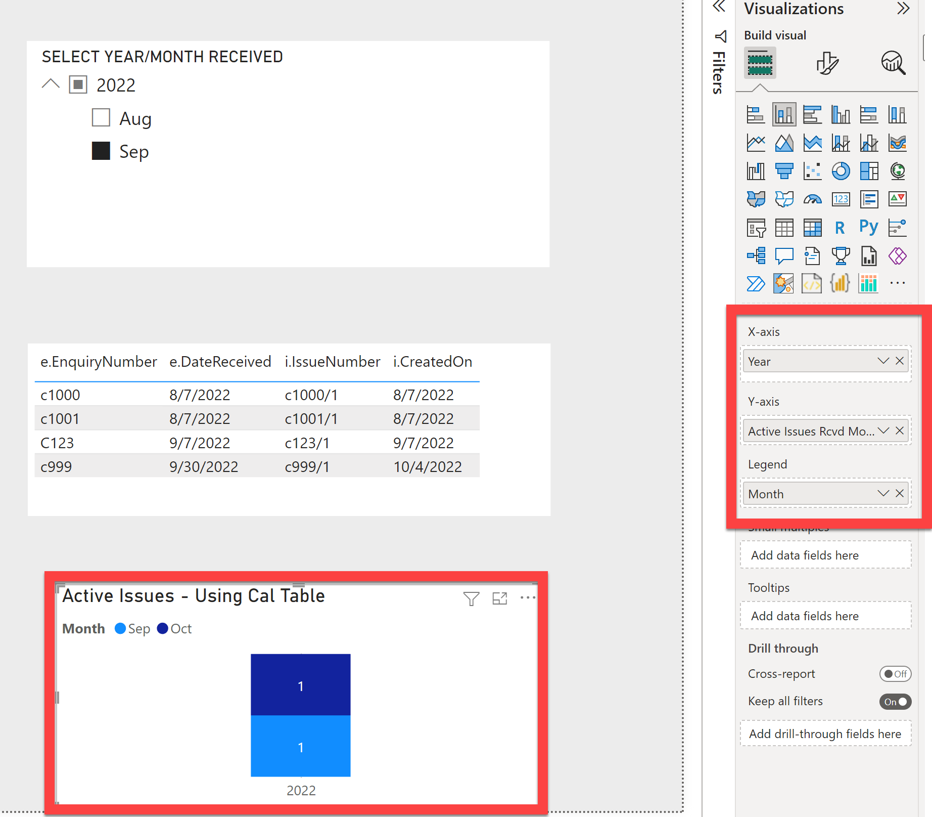

@AussieDragon ,
See if this does the trick:
Used MonthDateSort field to link disconnected slicer values to filter condition via DAX.
Active Issues Rcvd Months =
VAR SelRcvd =
VALUES( 'Disconn Cal'[MonthofYearSort] )
VAR Result =
CALCULATE(
   [Active Issues],
   t_Fact[MonthofYearSort] IN SelRcvd
RETURN Result
Full solution file attached below.  Hope this is helpful.
- Brian

Thank you. That looks pretty impressive and solves the issue. Now I just have to figure out how you did it lol :slight_smile:
I am assuming it is not possible to get the disconnected values into a stacked column chart.
No problem…
Ah, sorry, I meant the actual “Select Year/Month Received” filter
