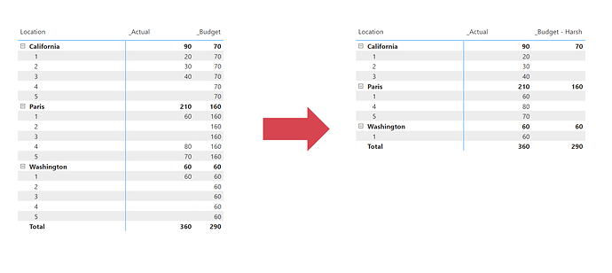

Please I have a measure (_budget) in a matrix table that has no relationship with the filtered rows (zones), I will like to make the zones values blank and also return only zones with _actual values
I have tried using different suggestion like using the hasonefilter etc , but I could not get it. Please any idea on an aproach
sample pbix file attached
Thank you

Hello @akeko ,
So you want to transform the result as per the screenshot provided below -
In that case, below is the measure provided for the reference -
_Budget - Harsh =
IF( NOT ISINSCOPE( Zone[Zone] ) ,
SUM( Sheet1[Budget] ) )
Hoping you find this and meets your requirements that you’ve been looking for.

Thanks, It worked. I have never used the inscope function
