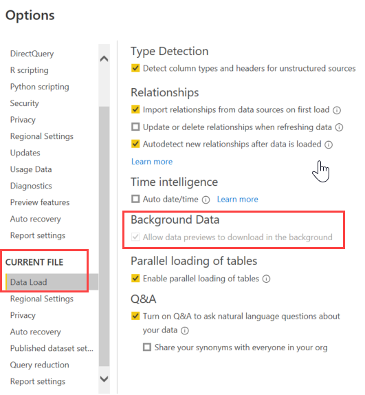

Here are my Data Load settings.

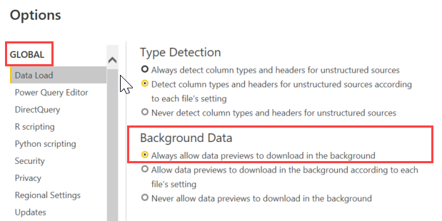

Bill, if you don’t have sensitive data or are never accessing external data sources you can safely do this: Under Global go to Privacy and select “Always ignore Privacy Level settings”
If you have sensitive data and are accessing external data sources you can decide file by file:
Under Current File go to Privacy and select "Ignore the Privacy Level and … "

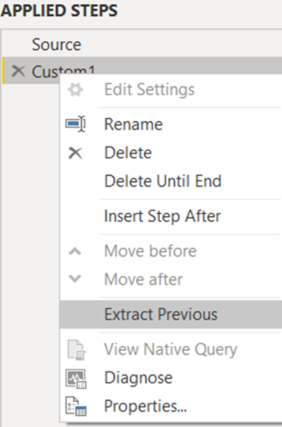

Otherwise rebuild (split) the query that you do not have internal and external data sources combined in it:
If you use Extract Previous splitting the query is relatively simple. M
