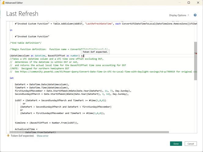

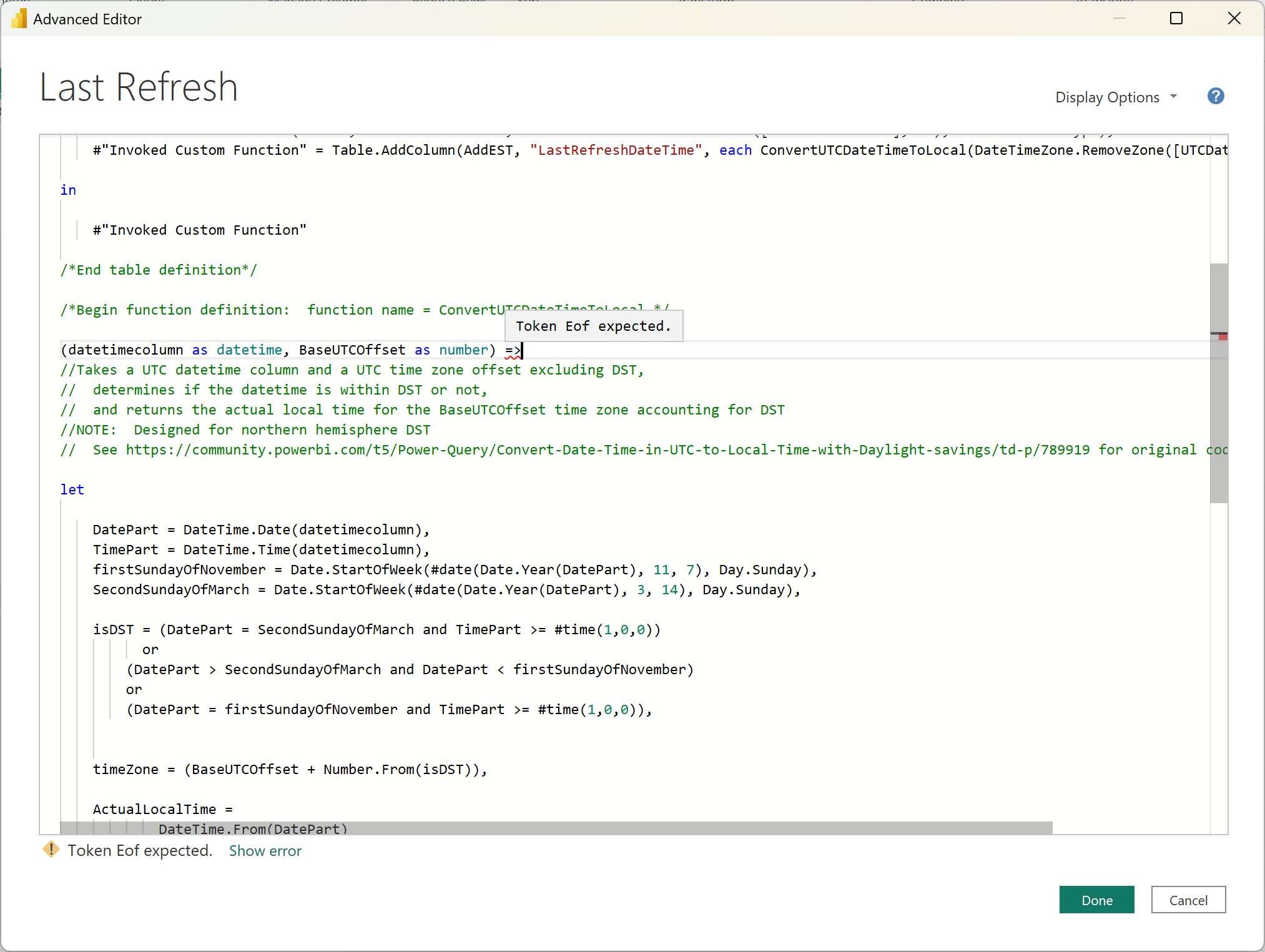

I am trying to use your function for last refresh date but I am getting a token end of file expected error in the following location:
Any idea how to fix this?
Hi @michael.wescott7226,
The code file actually contains multiple chunks of M and DAX code that should be copied separately to their target query editor. I kept them in one file to make it easier to get all the pieces at once. Best to open that in Notepad or a text editor, then copy the respective pieces you need.
You can see the comments I included for “End table definition” (that’s the end of the M code script to create the table), and for “Begin function definition…” (that’s the start of the M code for the function that converts the date). The DAX function to display the Last Updated value is below all that.
Just copy the code between each Begin/End set of comments and you’ll be all set!
