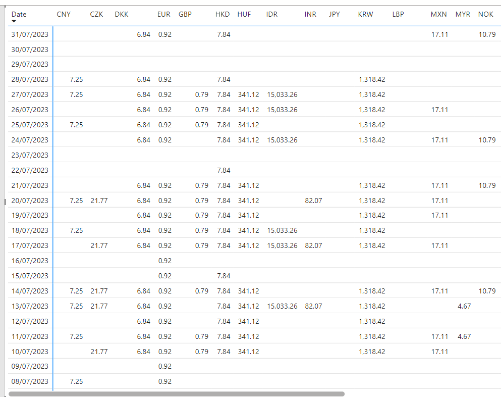

I prepared a simple table in which I want to lookup a rate for a selected currency and selected date. I am using LOOKUPVALUE function, which looks as below:
LOOKUPVALUE( MONTH_END_RATES[Month-end FX rate],
MONTH_END_RATES[Date], VALUES( DATES[Date] ) ,
MONTH_END_RATES[Currency], VALUES(BANK_NAV_ALL[LCY] ) )
And the results are shown in the table below:
As you can see, there are many blanks in the table. I was wondering why is that but discovered that I get blanks if there are no entries booked with a given date. For example, there were no any bookings for CZK on 31st July 2023. The problem is that I would like to show a balance for that date, so I need to find a proper FX rate.
Is there any way to display FX rates values for each date, despite the fact that table a) does not contain entries under each date and each currency?
