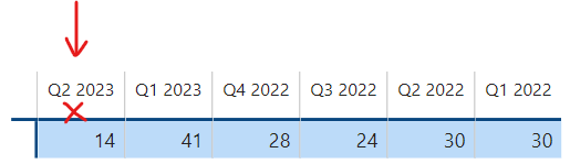

this is the result:

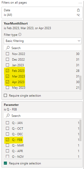

To decide when the quarter starts and from which month to start, I use these filters from the Filter Pane
At the moment, this calculation is showing me, but it is wrong because the Q2 that is being displayed should not be there, since the calculation should be from Q1, plus previous 4 quarters:
