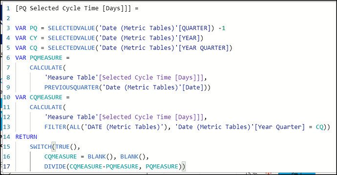

Here is the query for one of the measures called [QoQ (%)] for Cycle Time (days):
[PQ Selected Cycle Time [Days]]] =
VAR PQ = SELECTEDVALUE('Date (Metric Tables)'[QUARTER]) -1
VAR CY = SELECTEDVALUE('Date (Metric Tables)'[YEAR])
VAR CQ = SELECTEDVALUE('Date (Metric Tables)'[YEAR QUARTER])
VAR PQMEASURE =
    CALCULATE(
        'Measure Table'[Selected Cycle Time [Days]]],
        PREVIOUSQUARTER('Date (Metric Tables)'[Date]))
VAR CQMEASURE =
    CALCULATE(
        FILTER(ALL('DATE (Metric Tables)'), 'Date (Metric Tables)'[Year Quarter] = CQ))
RETURN
    SWITCH(TRUE(),
        CQMEASURE = BLANK(), BLANK(),
        DIVIDE(CQMEASURE-PQMEASURE, PQMEASURE))

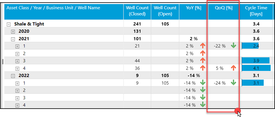

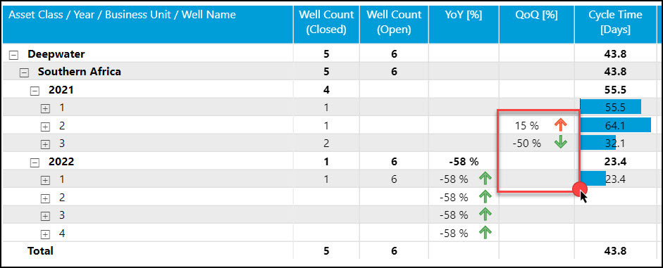

Here is a screenshot of the table visual where I have put a box around the measure above:
Now when you do the manual calcs for the quarter over quarter variance with cycle time (days), this is what you get:
2022Q1 = ((3.1 - 4.1)/4.1) = -24%
2021Q4 = ((4.1 - 3.9)/3.9) = +5%
2021Q3 = ((3.9 - 2.4)/2.4) = +63%
Highlighted above in bold and referencing the screenshot, you can see that the measure is not returning the correct variance for 2021Q3 because Q2 is blank (no operations during this time). Instead of returning a blank, i want to skip that quarter and calculate with the 2020Q1 value which will return +63%.

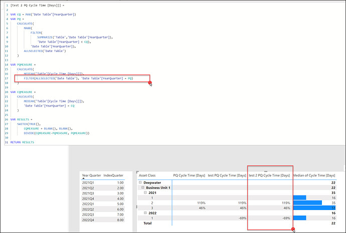

I tried this method on the dummy file and it worked. This solution is more efficient because I do not have to write how many quarters to go back in the calculation, which is already captured in the filter argument. I still have to include the new custom column in my date table because my original [Year Quarter] column is text string but this should be a easy fix since my date table is in the dataflow. Below is the ‘test 2’ measure using the new DAX query. The only adjustment I needed to make was to include an FILTER/ALLSELECTED() function in the [PQMEASURE] variable. Thanks again for the help
DummyFile.pbix (80.3 KB)
